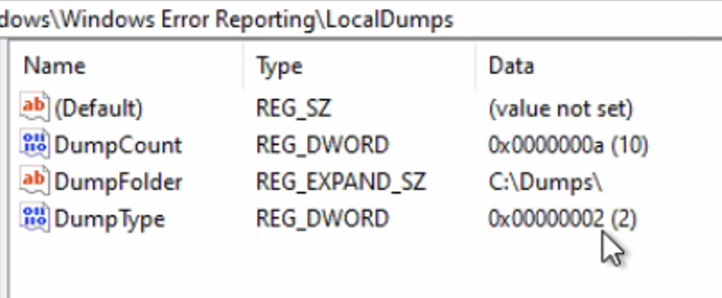

1. Open "regedit" on the server in question and navigate to the following registry location:
HKEY_LOCAL_MACHINE\SOFTWARE\Microsoft\Windows\Windows Error Reporting\LocalDumps
2. If the "LocalDumps" folder does not exist in the registry, create it.
3. Now, inside this folder you should create the following registry keys/values for Name, Type and Data.
i.    "DumpFolder" as a REG_EXPAND_SZ to something like C:\Dumps\
ii.   "DumpCount" as a REG_DWORD to 10 // this will limit to a maximum of 10 dump files
iii.  "DumpType" as a REG_DWORD to 2 // this creates a full process dump
4. Reboot the hub server for the registry changes to take effect.
