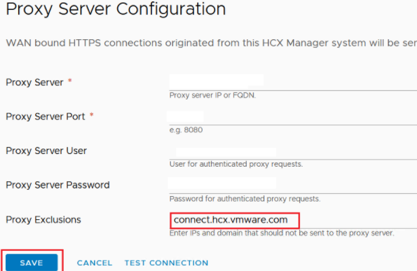

.Note: After upgrading to HCX 4.11, hyperscaler systems become automatically disconnected from VMware activation server "connect.hcx.vmware.com" and system will start operating in the local activation mode.

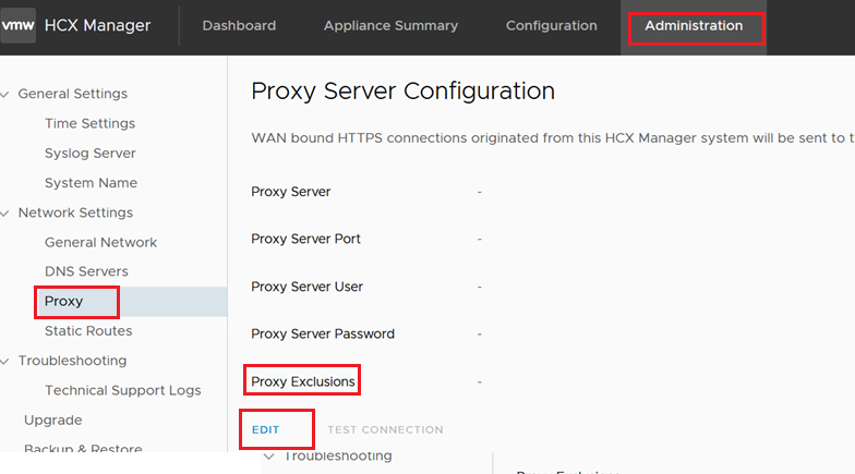

Edit the HCX proxy settings to add an exclusion for connect.hcx.vmware.com
https://<hcx-manager-ip>:9443Navigate to Administration --> Proxy --> Proxy Exclusions --> Edit
