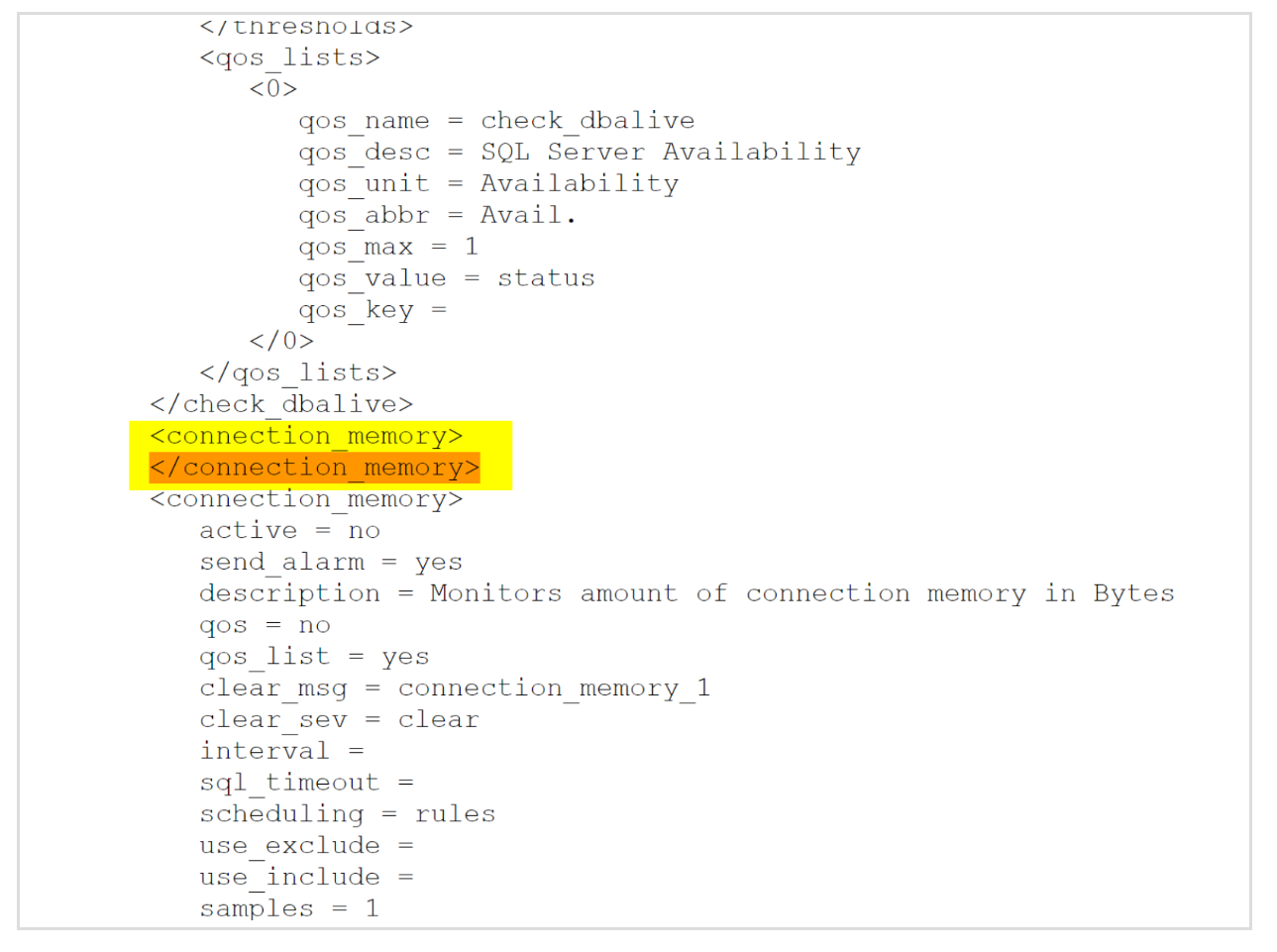

I tried to investigate corruption via Notepad++ but I was unable to found bad entry/characters/profile in the sqlserver_monitor.cfg  configuration file.

These empty sections comprised the dupes like shown above so searched on:
</connection_memory>
</0>
</lock_memory>
</optimizer_memory>
</sqlcache_memory>
</total_memory>
...and then I deleted those two lines for each dupe to repai the cfg file - what you see highlighted below in yellow.

  9. The original sqlserver_monitor.cfg had some duplicated section tags which needed to be removed.
