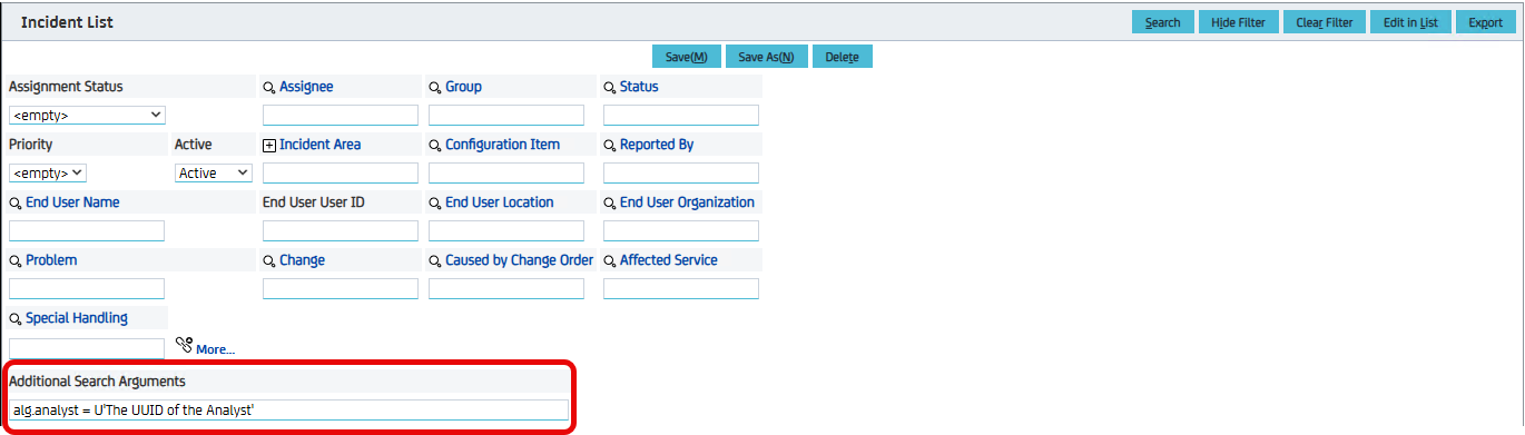

When we add a filter to list_in page with "IN" like this "alg.analyst IN ( U'The UUID of the Analyst' )" the number of records returned is wrong
when adding with equal sign like this "alg.analyst = U'The UUID of the Analyst' " the number of returned records is correct.
