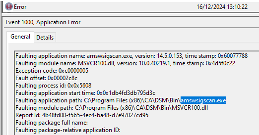

Signature Scan shows ERROR state for a large group of machines (this could happen for Scalability Servers and even the Domain Manager itself) and Event Viewer shows a crash of amswsigscan.exe:

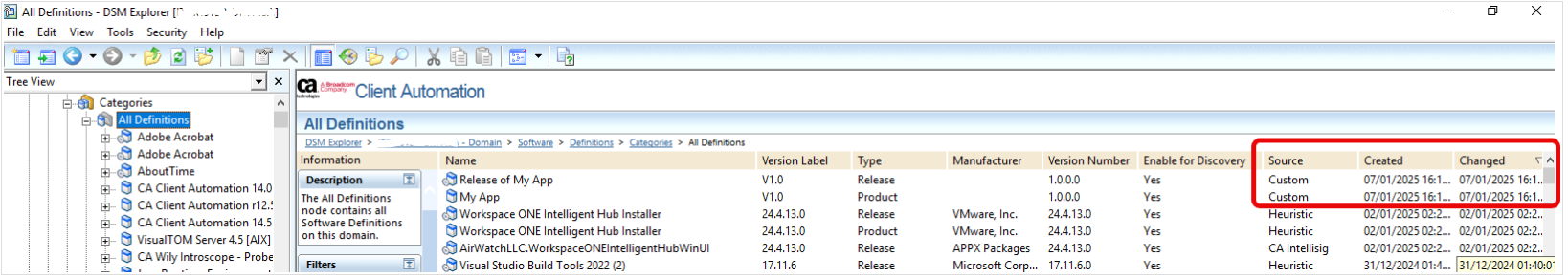

Error code 6 generally means that Signature Scan tried to process the Signatures (on the XML file) and failed to do it. THis could be because some of the newly added signatures were bad formed or with some wrong data. The solution is to delete and recreate the recently added signatures, which are probable those who caused the issue.
One way to validate this would be to sort by "Changed" date and filter for "Source" as 'Custom':
