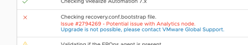

During the pre-upgrade assessment tool check, you may encounter the following error message.
Aria Operations 8.1.1 to 8.6.4
8.10 and later
