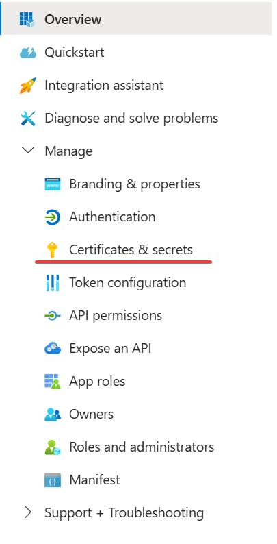

  2. Navigate to the Azure Console -> App Registrations -> select the App Registration associated that displays the same Application ID as collected in Step 1 -> Selecting the Certificates & Secrets option across the left Nav -

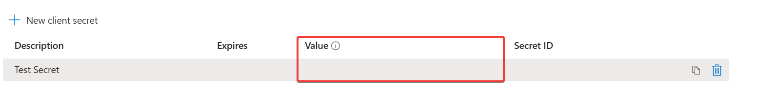

  3. All existing client secrets should be listed, you will likely find the current one has reached its expiry time. Please then select the "New Client Secret Option highlighted below -
  4. You will be prompted to define a description for the Ssecret and an expiry time.
  5. Once the secret has been generated copy the entry from the "Value" field (highlighted below) rather than the Secret ID field.

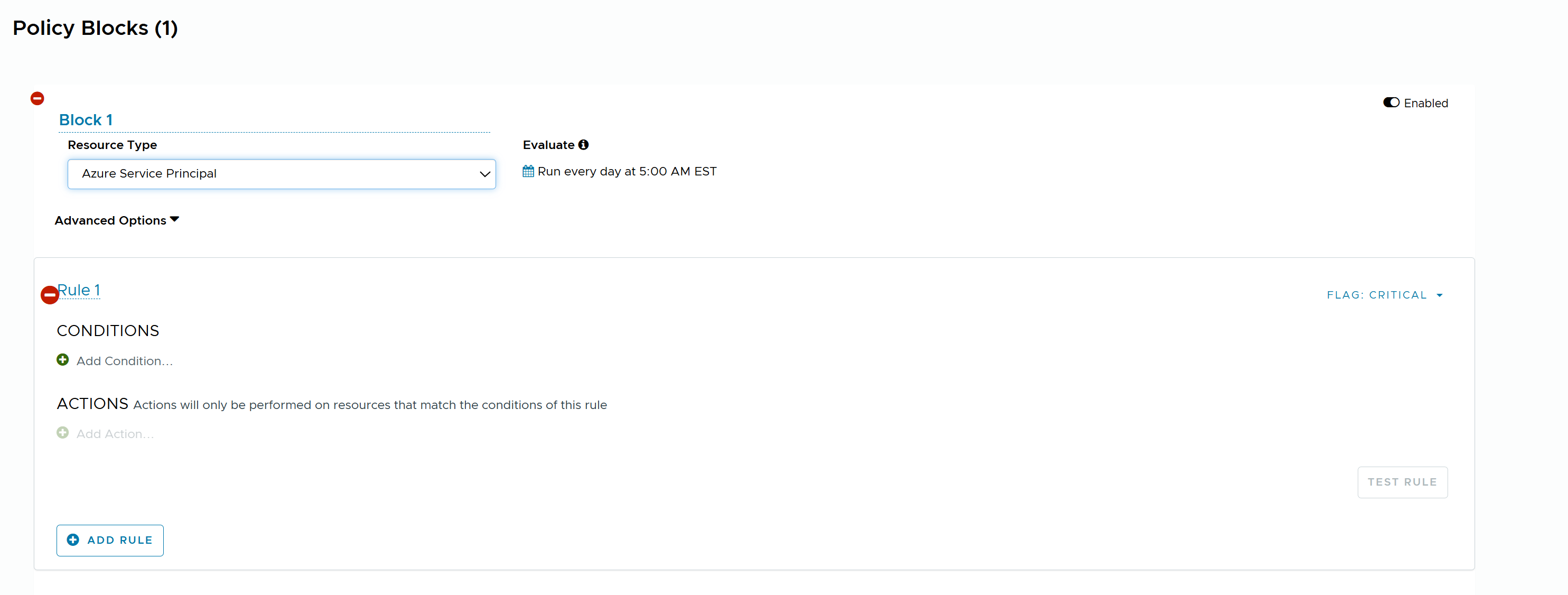

1. Navigate to Governance -> Policies, and select Create New Policy
2. Within the policy set the resource type as Azure Service Principal -

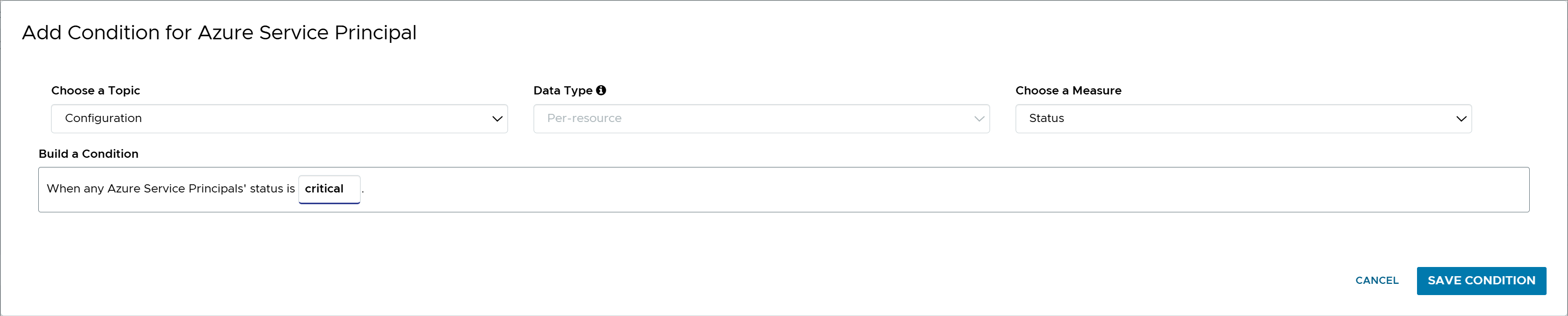

3. For the condition set the topic as configuration, and the measure as status, and set the "When any Azure Service Principals' status is" dropdown to critical as per the below -
