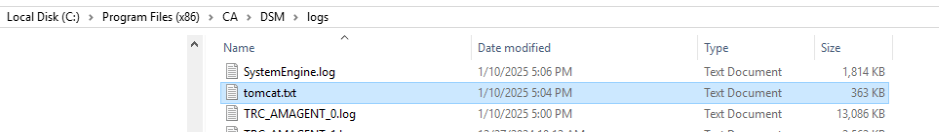

  6. The file <dsm_path>\logs\tomcat.txt is generated and contains SSL detailed communication logs (ex: C:\Program Files (x86)\CA\DSM\logs\tomcat.txt)
    File <dsm_path>\logs\wac_log.txt could also be checked.
