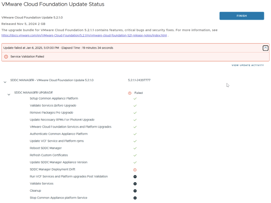

  • SDDC update from 5.2.1.0, 5.2.1.1, 5.2.1.2 or 9.0 fails on "SDDC Manager Deployment Drift" with an error message as shown below

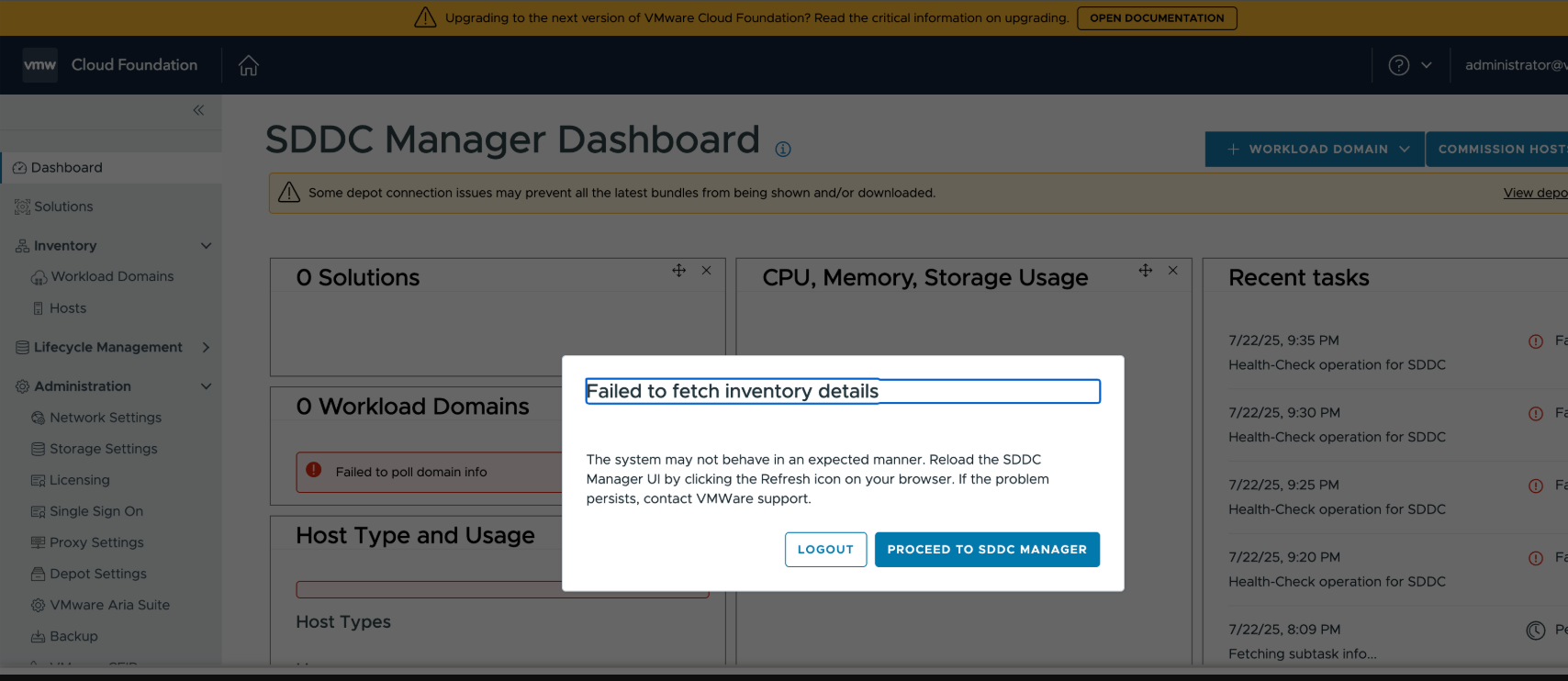

  • Also when upgrading to 5.2.2 the symptom could be different. After reboot the SDDC Manager UI will fail to load with error "Failed to fetch inventory details".
  • As part of SDDC update workflow, auto reboot for SDDC manager is initiated. /var/log/vmware/vcf/commonsvcs/commonsvcs.log report, in this example, failure to start 'domain manager' service
    YYYY-MM-DD HH:MIN INFO [common,0000000000000000,0000] [com.zaxxer.hikari.HikariDataSource,SpringApplicationShutdownHook] HikariPool-1 - Shutdown initiated...
    YYYY-MM-DD HH:MIN INFO [common,0000000000000000,0000] [com.zaxxer.hikari.HikariDataSource,SpringApplicationShutdownHook] HikariPool-1 - Shutdown completed.
    YYYY-MM-DD HH:MIN INFO [common,0000000000000000,0000] [c.v.e.s.c.c.l.l.LogLayoutWithHeader,main] THIS LOG FILE IS MANAGED BY SDDC MANAGER
    YYYY-MM-DD HH:MIN INFO [common,0000000000000000,0000] [o.h.validator.internal.util.Version,background-preinit] HV000001: Hibernate Validator 8.0.0.Final
    YYYY-MM-DD HH:MIN INFO [common,0000000000000000,0000] [c.v.e.s.c.c.u.ComponentUpgradeRunner,main] Checking if a component upgrade is needed
    YYYY-MM-DD HH:MIN INFO [common,0000000000000000,0000] [c.v.e.s.i.s.VcfServiceInventoryServiceImpl,main] Get all VcfServices
    YYYY-MM-DD HH:MIN ERROR [common,0000000000000000,0000] [c.v.e.s.i.s.VcfServiceInventoryServiceImpl,main] Error while trying to retrieve service http://127.0.0.1/domainmanager/about status, 502 Bad Gateway: "<html><EOL><EOL><head><title>502 Bad Gateway</title></head><EOL><EOL><body><EOL><EOL><center><h1>502 Bad Gateway</h1></center><EOL><EOL><hr><center>nginx</center><EOL><EOL></body><EOL><EOL></html><EOL><EOL>"
  • /var/log/vmware/vcf/domainmanager/domainmanager.log reports service failure with an error, 'Failed to update VCF Services and Photon rpms in SDDC Manager' post reboot
    YYYY-MM-DD HH:MIN: INFO: Updated /var/log/vmware/vcf/lcm/thirdparty/upgrades/a5##-##-##-##-##760/vcf-platform/upgrade/vcf_platform_upgrade.status status file with data OrderedDict([('upgradeId', 'a5##-##-##-##-##760'), ('resourceId', 'ac3##-##-##-##-##bca'), ('upgradeStatusCode', 'INPROGRESS'), ('progress', 70), (' error', OrderedDict([('errorCode', None), ('errorDescription', None)])), ('startTime', 1736376825), ('endTime', 1736377186)])
    YYYY-MM-DD HH:MIN: INFO: Rebooting SDDC Manager
    YYYY-MM-DD HH:MIN: INFO: Execute cmd: sh -x /var/log/vmware/vcf/lcm/thirdparty/bundles/d5##-##-##-##-##600/thirdparty/reboot_script.sh &
    YYYY-MM-DD HH:HH:MIN: INFO: http://localhost/domainmanager/about is not accessible, retry after 10 seconds
    YYYY-MM-DD HH:HH:MIN: INFO: URL: http://localhost/domainmanager/about
    YYYY-MM-DD HH:HH:MIN: ERROR: RC: , OUT: ERR: Expecting value: line 1 column 1 (char 0)
    YYYY-MM-DD HH:HH:MIN: ERROR: Failed to update VCF Services and Photon rpms in SDDC Manager
    YYYY-MM-DD HH:HH:MIN: INFO: RC: 1, OUT:
    YYYY-MM-DD HH:HH:MIN: INFO: ERR: Traceback (most recent call last):
     File "/var/log/vmware/vcf/lcm/thirdparty/bundles/d5##-##-##-##-##600/thirdparty/vcf-platform-upgrade/bin/vcf_platform_upgrade.py.copy", line 521, in <module>
     wrapper.update_status(return_code=1, status='COMPLETED_WITH_FAILURE',
     File "/var/log/vmware/vcf/lcm/thirdparty/bundles/d5##-##-##-##-##600/thirdparty/vcf-platform-upgrade/bin/../../wrapper.py", line 187, in update_status
     raise Exception
  • Similar to Domain manager, operations manager service also fails to auto start. Error in /var/log/vmware/vcf/operationsmanager/operationsmanager.log
