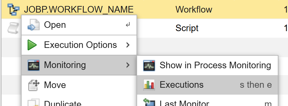

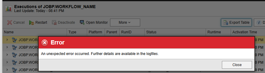

When attempting to use the "Export table" button on an object in the AWI, choosing Monitor -> Executions
the following error occurs: An unexpected error occurred. Further details are available in the logfiles.
No error shows in the AWI log file.  Turning on tracing for the AWI in client 0 shows the following in the log:

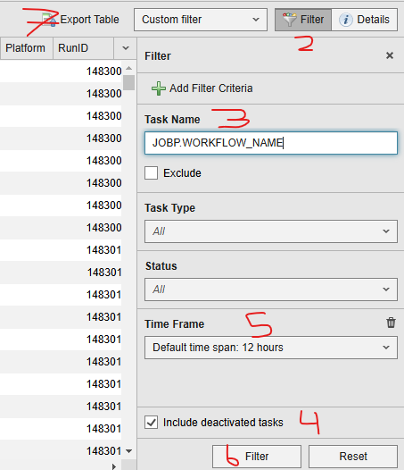

Workaround 1 (done through Process Monitoring)
  1. Right-click on the object and choose "Monitoring" -> "Show in Process Monitoring"
  2. On the right side click the "Filter" button
  3. Be sure the filter is done by task name
  4. On the bottom of the filters, choose "Include deactivated tasks"
  5. For timeframe, put in the time frame you'd like to use - I'd recommend using "All tasks in timeframe" and a day of time or the default of 12 hours, but longer can be used if necessary
    Click the "Filter" button
  6. Use the "Export table" button in the upper right of the Process Monitoring screen
