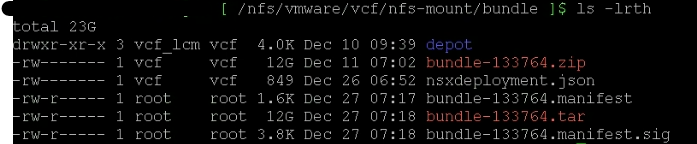

NSX deployment fails due to file permission issue.
In SDDC Manager the files get default permissions of 600 instead of 644 so we need to add more permissions to the newly created files. This way the service users will be able to read the files.

2024-12-26T08:57:27.778+0000 ERROR [vcf_lcm,676dxxxxxxxxxxxxxxxxx,2755] [c.v.e.s.l.s.i.BundleUploadServiceImpl,http-nio-127.0.0.1-7400-exec-9] /nfs/vmware/vcf/nfs-mount/bundle/bundle-xx.manifest file can not read by LCM due to insufficient permissions. vcf_lcm user must have read and write access to /nfs/vmware/vcf/nfs-mount/bundle directory or upload bundle files from any directory where vcf_lcm user have read and write access.
2024-12-26T08:57:27.779+0000 ERROR [vcf_lcm,676d676dxxxxxxxxxxxxxxxxx,2755] [c.v.v.l.r.a.c.v.b.BundleController,http-nio-127.0.0.1-7400-exec-9] Bundle Upload Failed com.vmware.evo.sddc.lcm.model.error.LcmException: /nfs/vmware/vcf/nfs-mount/bundle/bundle-xx.manifest file can not read by LCM due to insufficient permissions. vcf_lcm user must have read and write access to /nfs/vmware/vcf/nfs-mount/bundle directory or upload bundle files from any directory where vcf_lcm user have read and write access.The issue is resolved with VCF 5.2 release.
In the interim, below workaround could be followed.
1. Take a snapshot of the SDDC manager
2. Login to SDDC SSH with vcf user and elevate to root
3. Navigate to bundle directory -
cd /nfs/vmware/vcf/nfs-mount/bundle
4. Change the file permissions and ownership (if required) of the bundle files -
chown vcf:vcf filename
chmod 644 filename
