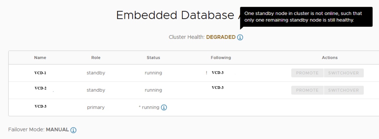

  • After a failed upgrade snapshot revert or increasing the capacity of the embedded PostgreSQL database on VMware Cloud Director Appliance by following the Increase PostgreSQL database disk , the Cluster Health shows DEGRADED or READ ONLY PRIMARY
    NOTE: '!' mark before the node means - standby node is detached from its upstream primary.

  • Cluster Health shows DEGRADED when the primary and one of the standby cells are online and operational, but the other standby cell is non-functional. The primary database is functional in this state, but if there is another database failure of either of the operational cells, the primary will become non-functional. The non-functional standby cell must be replaced with a new, functioning standby cell as soon as possible to restore the cluster to a Healthy state. The VMware Cloud Director UI and API are functional.
  • Cluster Health shows READ ONLY PRIMARY when there is an online primary database, but it is READ_ONLY because the environment does not have an operational standby cell. Two new standby cells must be deployed. The VMware Cloud Director UI and API are not available.
