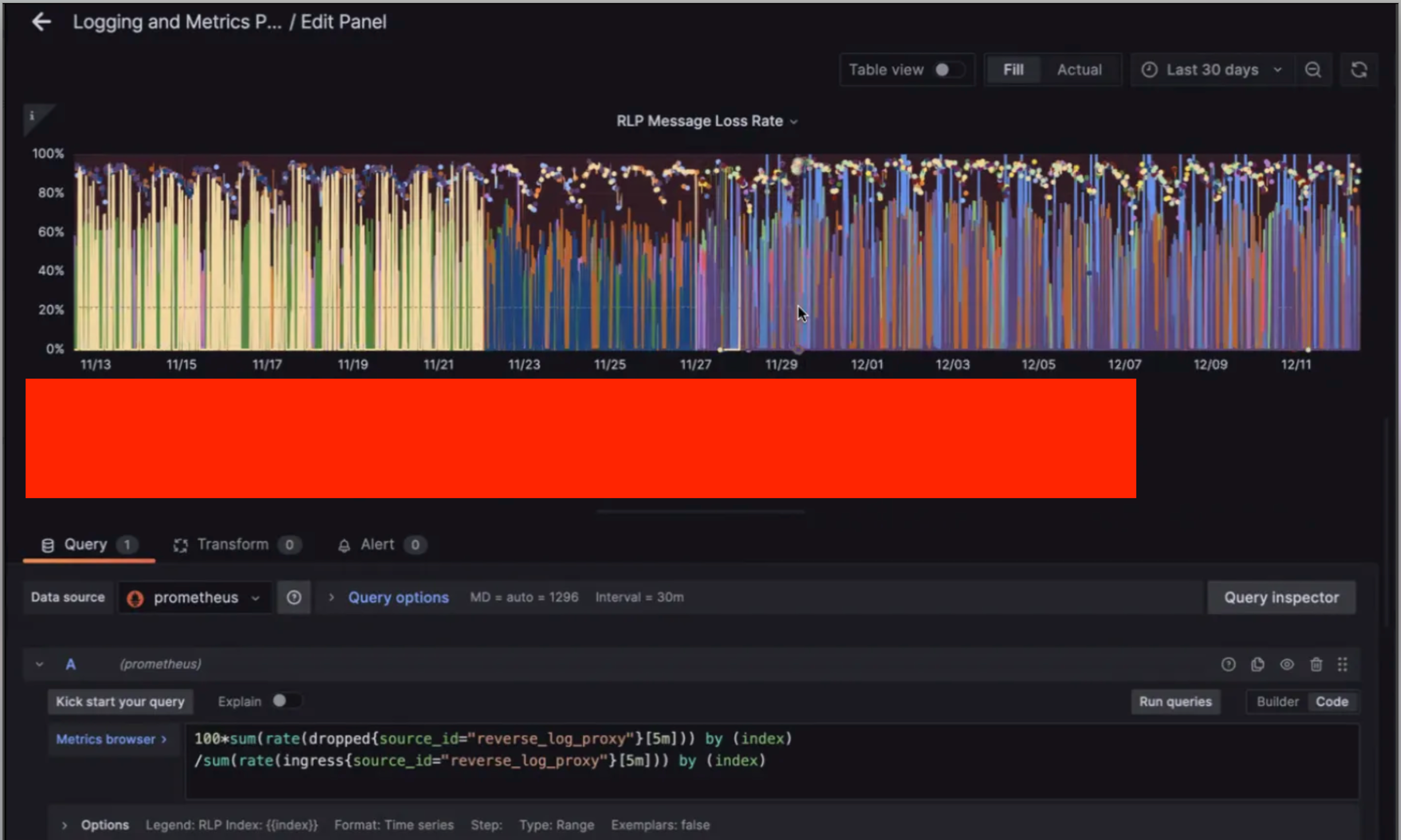

  • 2. Assuming we have Healthwatch installed, when we check the Healthwatch dashboard (Logging & Metrics Pipeline > RLP Message Loss Rate), we observe a high RLP Message loss rate:
There are a few options we can consider to mitigate this issue:

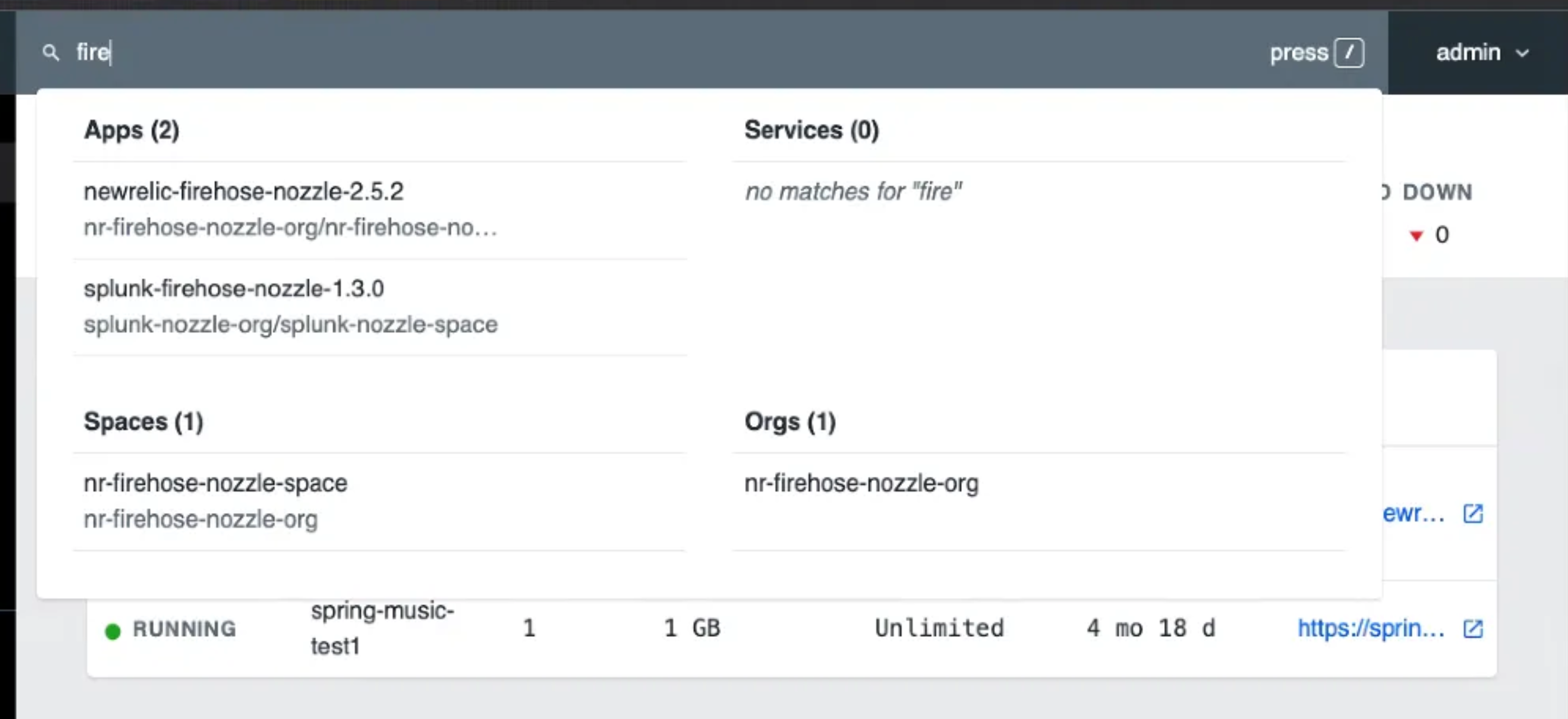

In this case, we can log into Apps Manager, and search for the keywords "nozzle" or "firehose"
From here, we can turn off the unnecessary newrelic nozzle or delete them altogether.

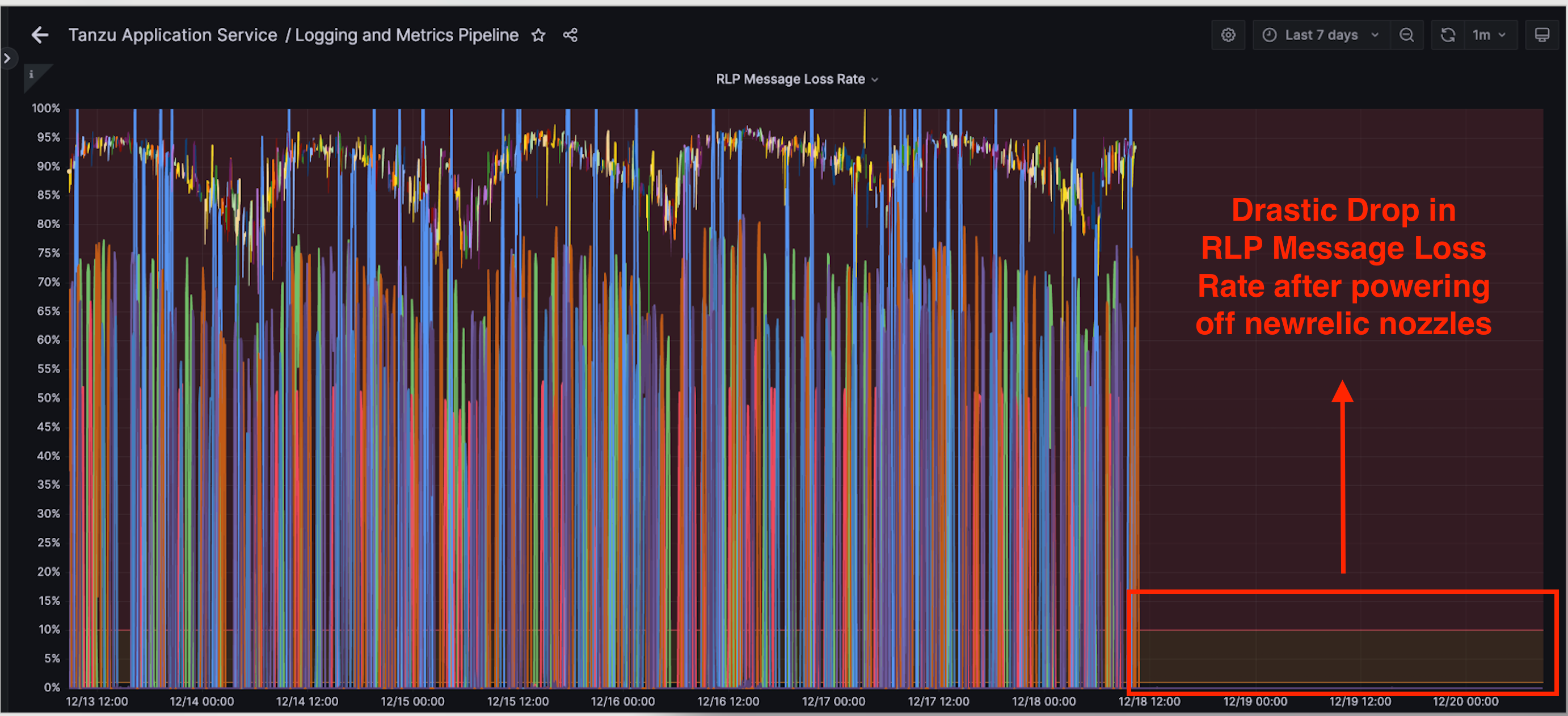

After implementing one or more options stated above, we would expect the result to be a decrease or elimination of the rate of dropped envelopes and decrease in the RLP Message Loss rate:
