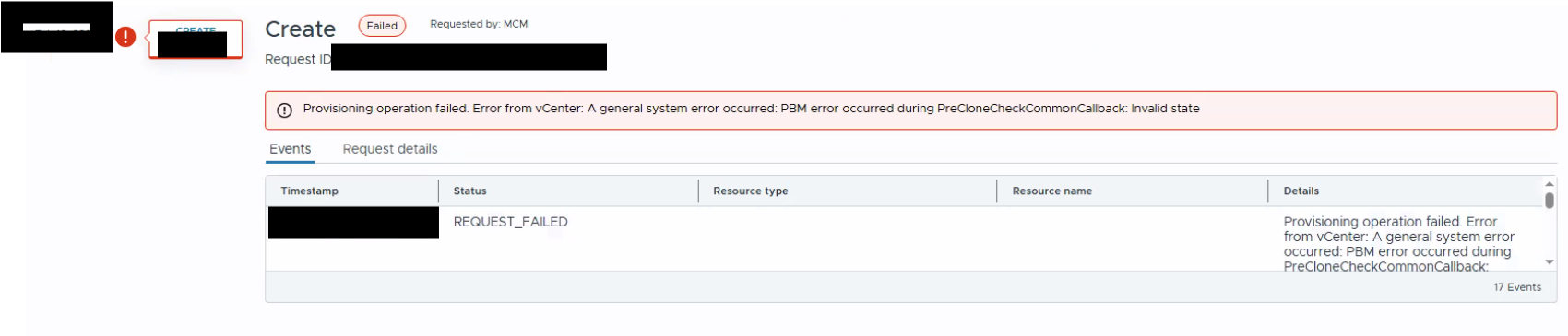

  • Deployment of OVF via OVF Tool fails when using a particular user account fails with the following error in vCenter UI : A general system error occurred: PBM error occurred during PreCreateCheckCallback: Invalid state
  • OVF deployments initiated through the vCenter UI when logged in as the [email protected] user are successful.
Error on VRA

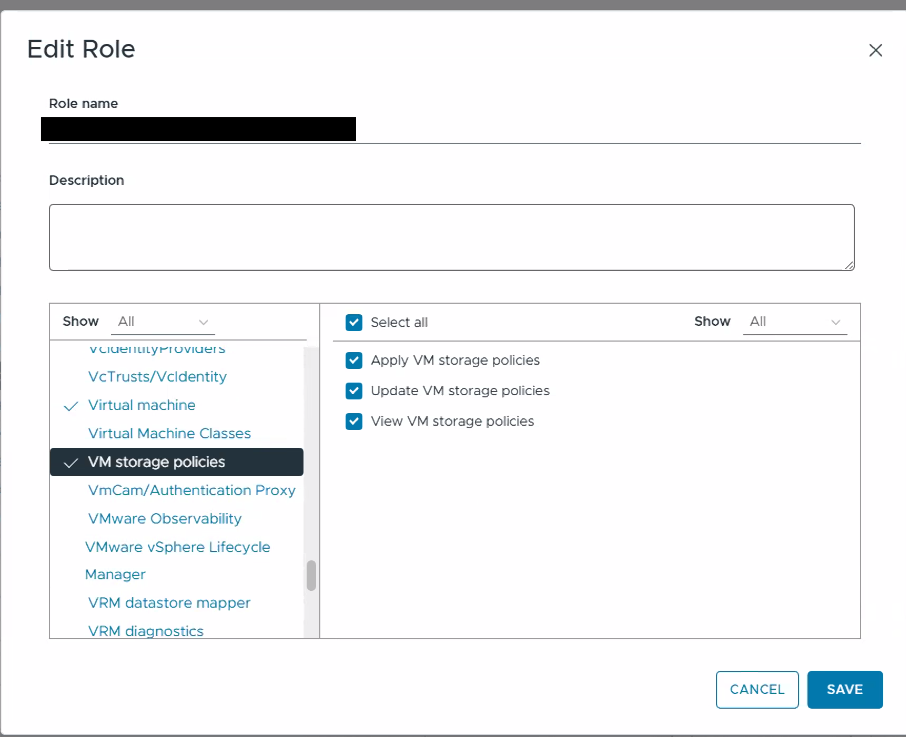

Any user attempting to create a virtual machine (VM) or disk with a defined storage profile ID must have the "StorageProfile.View" privilege assigned at the vCenter root level.
Please find the below doc for more details:
VM Storage Policies Privileges
To resolve the issue, ensure that the "StorageProfile.View" permission is assigned to the particular user at the vCenter root level.
  • Log in to the vSphere Client as an administrator.
  • Navigate to Administration -→ Access Control -→ Roles
  • Select the Role to modify and click Edit.
  • Navigate to the section "VM storage policies" and select the checkbox next to “View VM storage policies”. Save the changes.
  • For assigning the Role to a User/Group at the vCenter Root Level, select the vCenter instance and navigate to the "Permissions" tab.
  • Select the user/group, click on Edit and and ensure that the modified role is chosen from the dropdown.
  • Select propagate to child objects and click OK to apply the permission.
