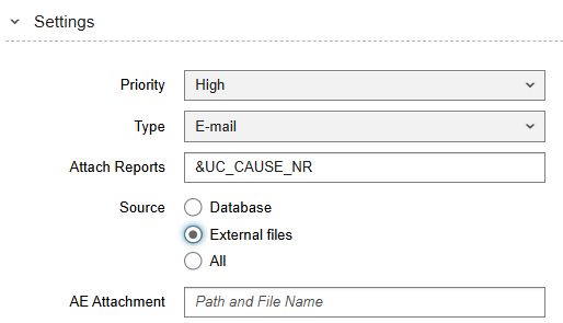

When kicking off a notification object of type Email that has "External Files" checked on the settings:
In the RA agent log when the email attempts to send, it shows the following in the RA log:
20241114/120158.708 - U02003012 An unknown message from partner 'AUTOMIC#CP003' could not be processed.
20241114/120158.708 - U00009907 Memory view 'Received 6465 bytes from AUTOMIC#CP003' (Address='n/a', Length='006465')
20241114/120158.709 -           00000000  01085543 45585641 5220FF16 19000053  >..UCEXVAR .....S<
20241114/120158.709 -           00000010  4E444D41 494C3230 31640005 00000041  >NDMAIL201d.....A<
20241114/120158.709 -           00000020  6C657274 3A204155 54383837 36443A30  >lert:   ...
No email is received in this case
