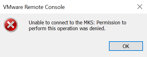

  • Console access to an encrypted virtual machine (VM) or a VM with a virtual TPM (vTPM) through the vCenter UI fails with the following error messages:
    • From web console: Unable to connect to the Virtual Machine web console: Permission to perform this operation was denied.
    • From VMware Remote Console (VMRC): Unable to connect to MKS: Permission to perform this operation was denied.

The error "Permission to perform this operation was denied" occurs because the user's assigned role is missing the Direct Access privilege under Cryptographic operations. This privilege is mandatory for acquiring a console ticket (webmks) for any encrypted Virtual Machine.
To restore console access, add the required privilege to the user's role:
  1. Log in to vCenter Server with administrative privileges.
  2. Navigate to Menu > Administration > Access Control > Roles.
  3. Select the specific role assigned to the user or group.
  4. Edit the role and enable the Cryptographic operations > Direct Access privilege.
  5. Click OK to save the changes.
