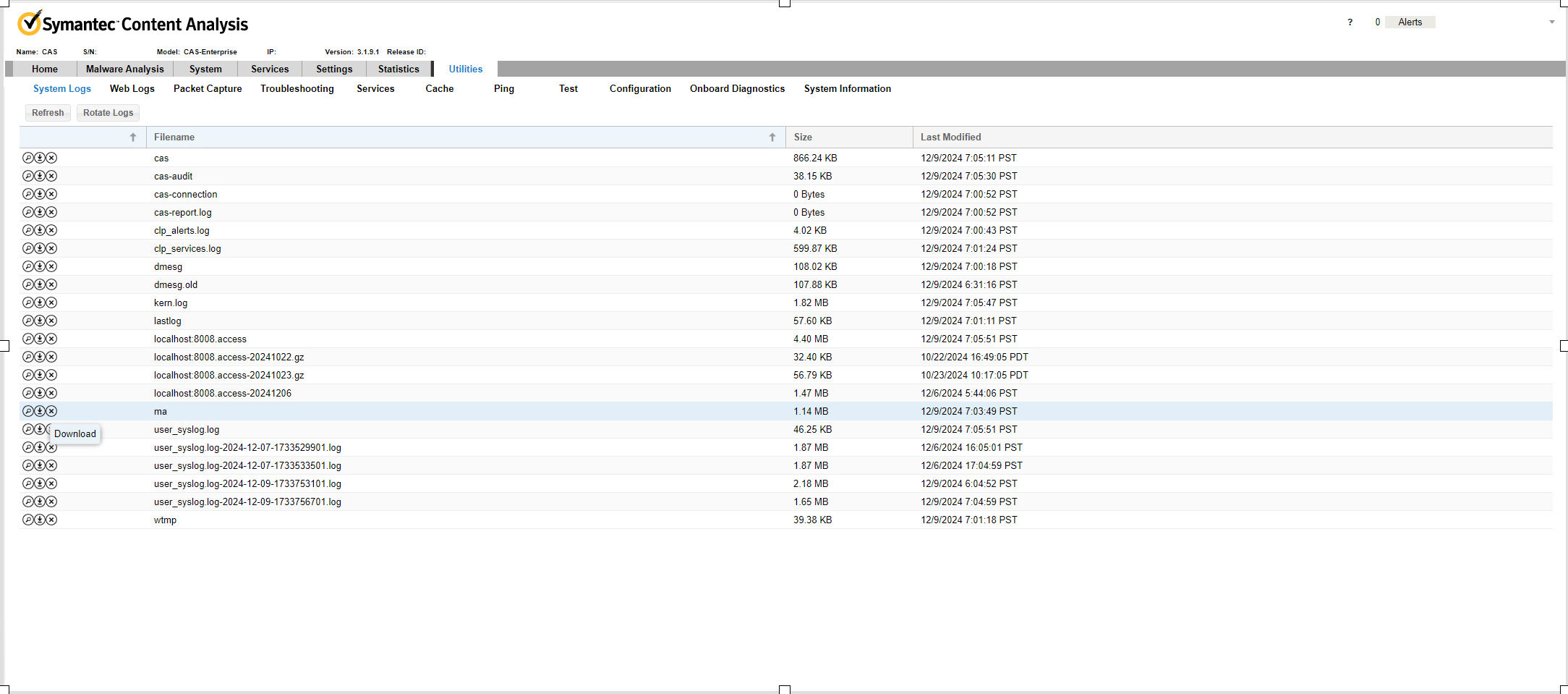

Further more, with the "ma" log, you are able to track all that's going on with Sandboxing, be it On-box sandboxing or Cloud Sandboxing. See the snippet below, for guidance on how to access/download this log file.
Important: Where the Sandboxing events aren't seen within any of the logs, it's a clear indication of either incomplete, or incorrect, configuration/implementation. Where the implementation is done correctly/completely, any other issues would be identified with specific errors/warnings, and can also be seen within the log data
