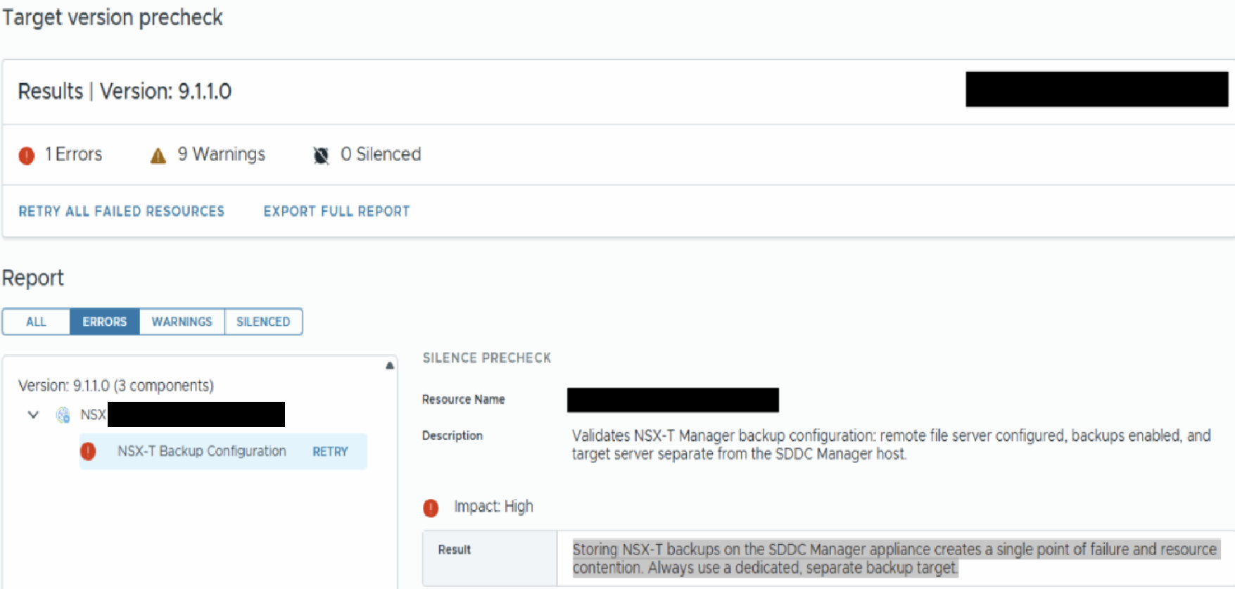

  • On VCF Operations 9.x or SDDC Manager 9.x, an NSX-T Backup Configuration error is encountered similar to below:
Storing NSX-T backups on the SDDC Manager appliance creates a single point of failure and resource contention. Always use a dedicated, separate backup target.

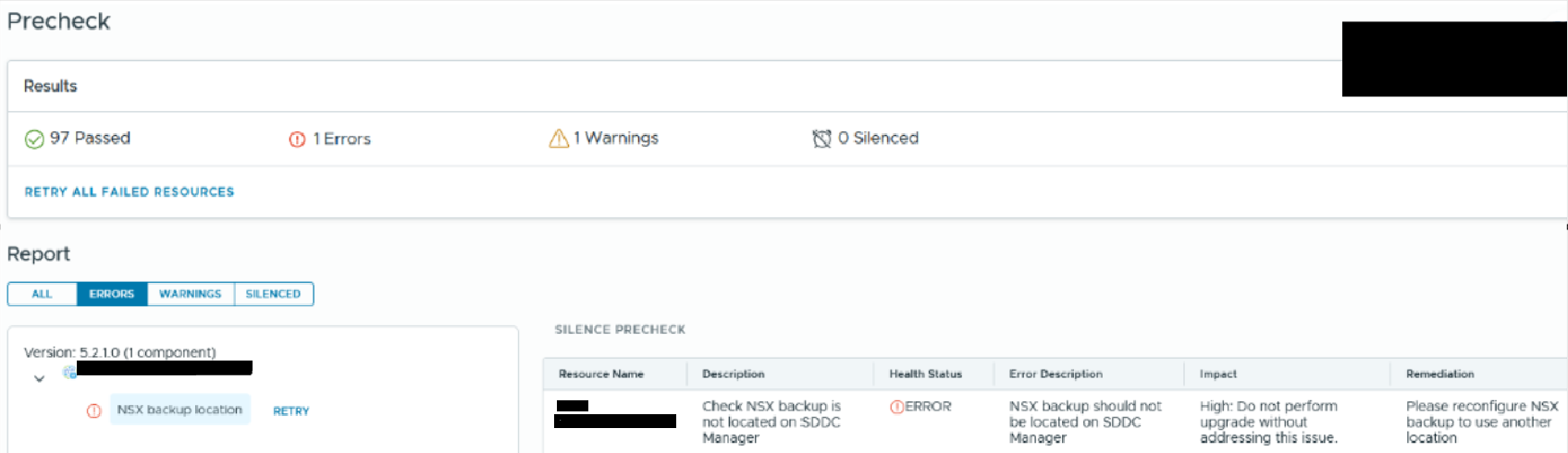

  • On the SDDC Manager 5.x an NSX Backup location error is encountered similar to below:
    NSX backup should not be located on SDDC Manager. Please reconfigure NSX backup to use another location

Configure a dedicated External Backup Server for NSX:
  1. Log in to the NSX Manager UI as admin and navigate to System > Backup & Restore.
  2. Edit NSX Backup settings and update the SFTP server IP/FQDN to a dedicated and supported external SFTP backup server.
  3. Save the configuration and perform a manual backup test via Backup Now to confirm successful file transfer.
  4. Return to the SDDC Manager UI and click Retry on the failed NSX-T Backup Configuration Precheck.
