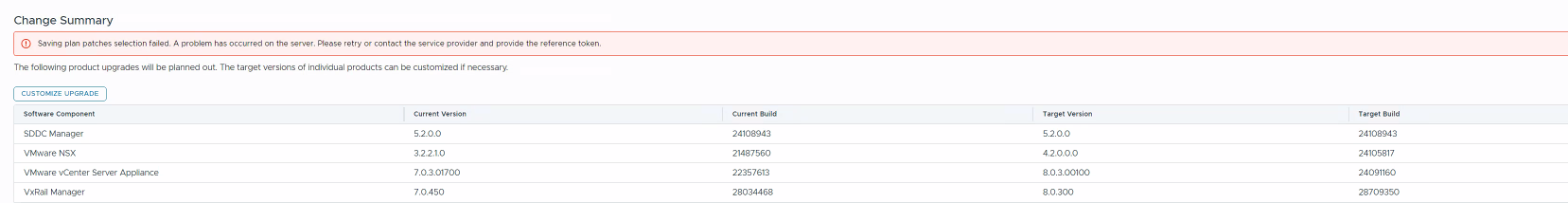

  • Bundles have been downloaded for patching the components - Particularly we are using OBTU for downloading the bundles.
  • Following the document  - Patching the Management and Workload Domains
  • During the Patch selection or customization you are unable to confirm/validate/customize patches. You get the error - "A problem has occurred on the server. Please retry or contact the service provider and provide the reference token" as below -
Validate Selection Error -
Confirm Patching Error -
