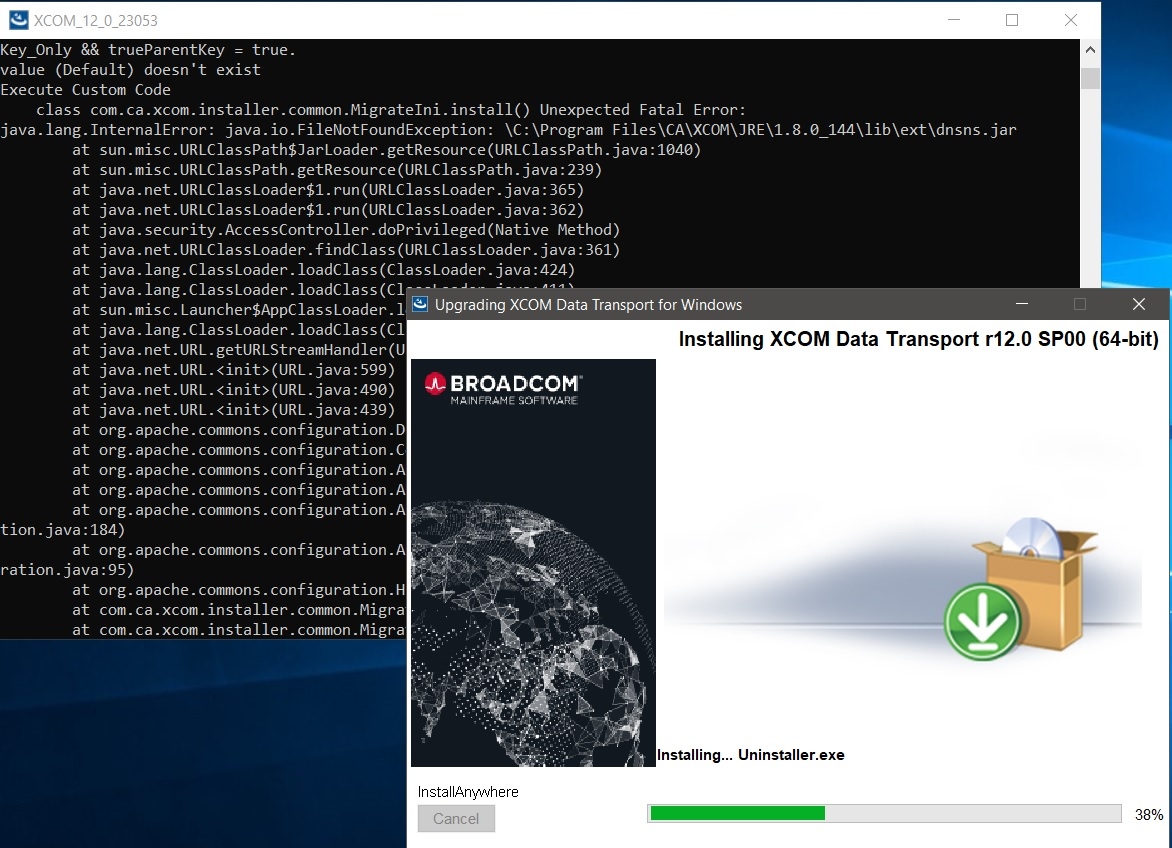

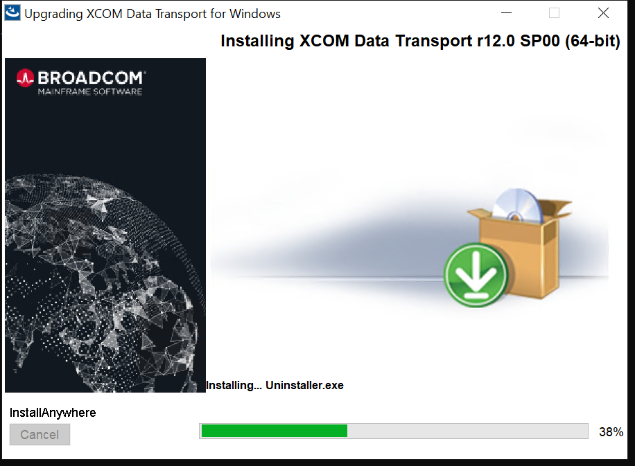

However the installer stops/hangs at 38% showing "Installing... Uninstaller.exe"
Support tested the same scenario.
They recreated the problem with CTRL key pressed at installer start which opens debug console and it shows a Java error:
Execute Custom Code
    class com.ca.xcom.installer.common.MigrateIni.install() Unexpected Fatal Error:
java.lang.InternalError: java.io.FileNotFoundException: \C:\Program Files\CA\XCOM\JRE\1.8.0_144\lib\ext\dnsns.jar
        at sun.misc.URLClassPath$JarLoader.getResource(URLClassPath.java:1040)
They checked directory "C:\Program Files\CA\XCOM\JRE\1.8.0_144\lib\ext\" and there was no file named dnsns.jar.
It had been deleted as part of the install process because it exists in the backup directory created: "C:\Program Files\CA\XCOM_R120BACKUP\JRE\1.8.0_144\lib\ext"
