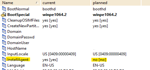

3- With this new Boot Image, Windows 11 24H2 could be installed but installation hangs during SD Agent installation (this problem should be resolved when certification of Windows 11 24H2 will be completed).
Set InstallAgent = No in OSIM job
SD Agent could be installed later using deployment Wizard
