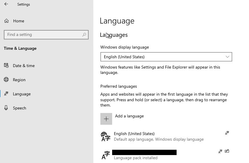

The Jasper Server was installed on a Windows server which was configured for a display language other than US/English
Go into the Windows Server's settings on the Jasper server and change the display language to English (United States), then re-attempt the integration process.
Per existing documentation (link), CA Business Intelligence JasperReports Server is supported only in English.
