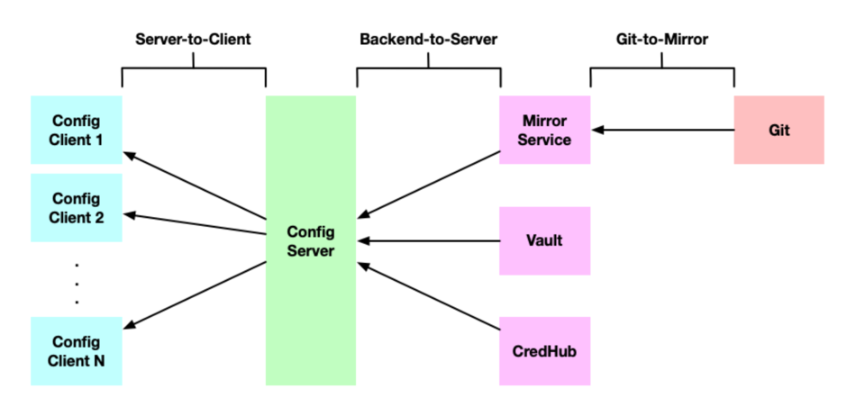

There are several configuration parameters which could affect the behaviour of the Config Client, Config Server and Mirror Service as described in the document (also shown in below image).
The Config Server service instance is actually backed by application running on TAS. When the Config Server app starts, it will not connect to either Config Client app or the Mirror Service. Instead, it will be empty in its local cache and waiting for request from the Config Client app.
When the Config Client app starts, it will attempt to load configuration properties from the binding Config Server service instance, which would consequently trigger a "git clone" operation to fetch data from the Mirror Service.
