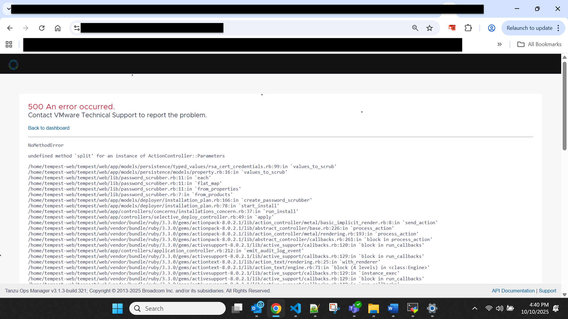

Apply Changes fails with error "Details: undefined method 'split' for an instance of ActionController::Parameters "

The symptom observed on this issue are errors referencing a property not defined similar to the example below:
500 An error occurred.
Contact VMware Technical Support to report the problem.
Back to dashboard
NoMethodError
undefined method `split' for an instance of ActionController::Parameters
/home/tempest-web/tempest/web/app/models/persistence/typed_values/rsa_cert_credentials.rb:99:in `values_to_scrub'

This issue can be caused by a property value from a staged product (tile) submitted via the API with an incorrect format. The bad value causes the property to error out as it can't be consumed.
Workaround
Revert back the changes by click on Revert back button top right beside Review Pending changes
To identify the property which causing this issue, use the API to query the properties of the existing staged products. This will allow to identify the product that persisted an incorrect value.
The product with the incorrect values will error out or return ActionController::Parameters somewhere in the response. Once the property with the incorrect value is identified the customer can modify it to the correct format.
Below is an example of how an invalid format can look:
## property value with incorrect format:
 .cloud_controller.encrypt_key:
   value:
     secret:
       secret: MYPASSWORD
 ## correct format for the property
   value:
     secret: MYPASSWORD
