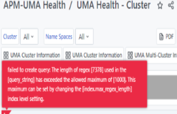

Default UMA dashboards is reporting the below error
"The length of regex[7378] used in the [query_string] has exceeded the allowed of [1000]. This maximum can be set by changing the [index.max_regex_length] index level setting
  • DX Operational Observability SaaS
  • DX Operational Observability On-premise
The problem is related to defect # DE619887
The fix will be part of the next release: DXO2 SaaS v25.1.1 release --  ETA = End of January 2025
