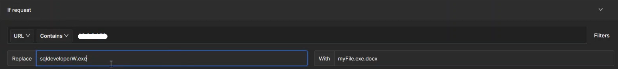

  1. Modify the SDM repository to set 'Prohibited File Types ' as .exe/.XML
  2. While uploading attachment use burf suit or some other way to replace a file name having .exe with a .txt file.

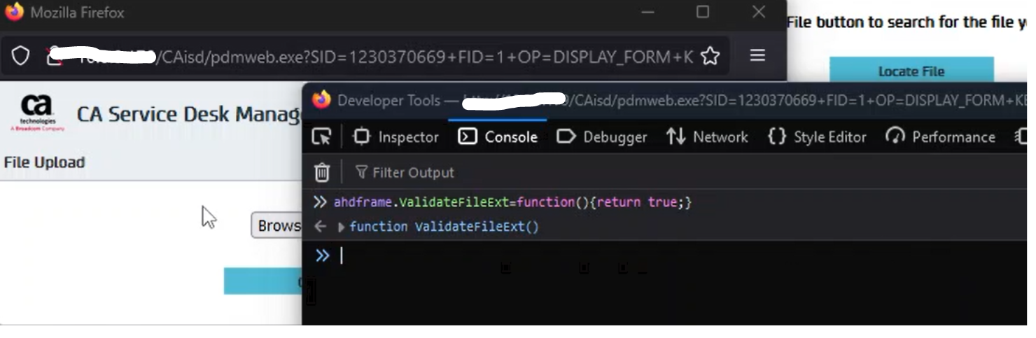

   3. Also, tweak the code to skip the validateFileExt method of the javascript layer
4. Upload of .exe file will be successful here.
