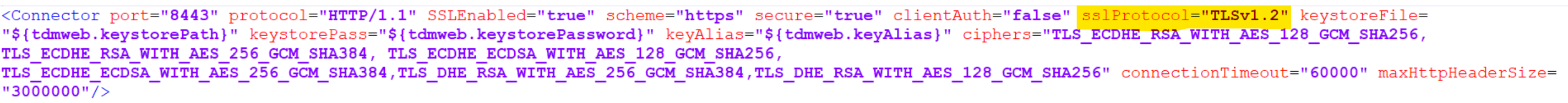

To rule out the Tomcat connect configuration, please check how the Connector was configured in working TDM 4.10 Portal. By default, the TDM 4.10 Connector is using the TLSv1.2 protocol, shown below:

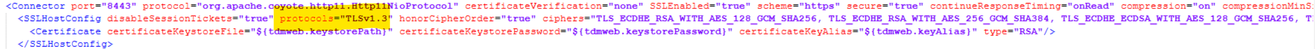

In TDM 4.11, the Tomcat default Connector configuration uses TLSv1.3:
If any devices, such as the load balancer, network gateways, or browsers, used in the environment does not support TLSv1.3, then there will be a protocol mismatch, resulting in an SSL Handshake failure.
To resolve the protocol mismatch with the Tomcat Connector, TLSv1.2 may need to be added to the TDM Portal 4.11 Tomcat Connector configuration.
