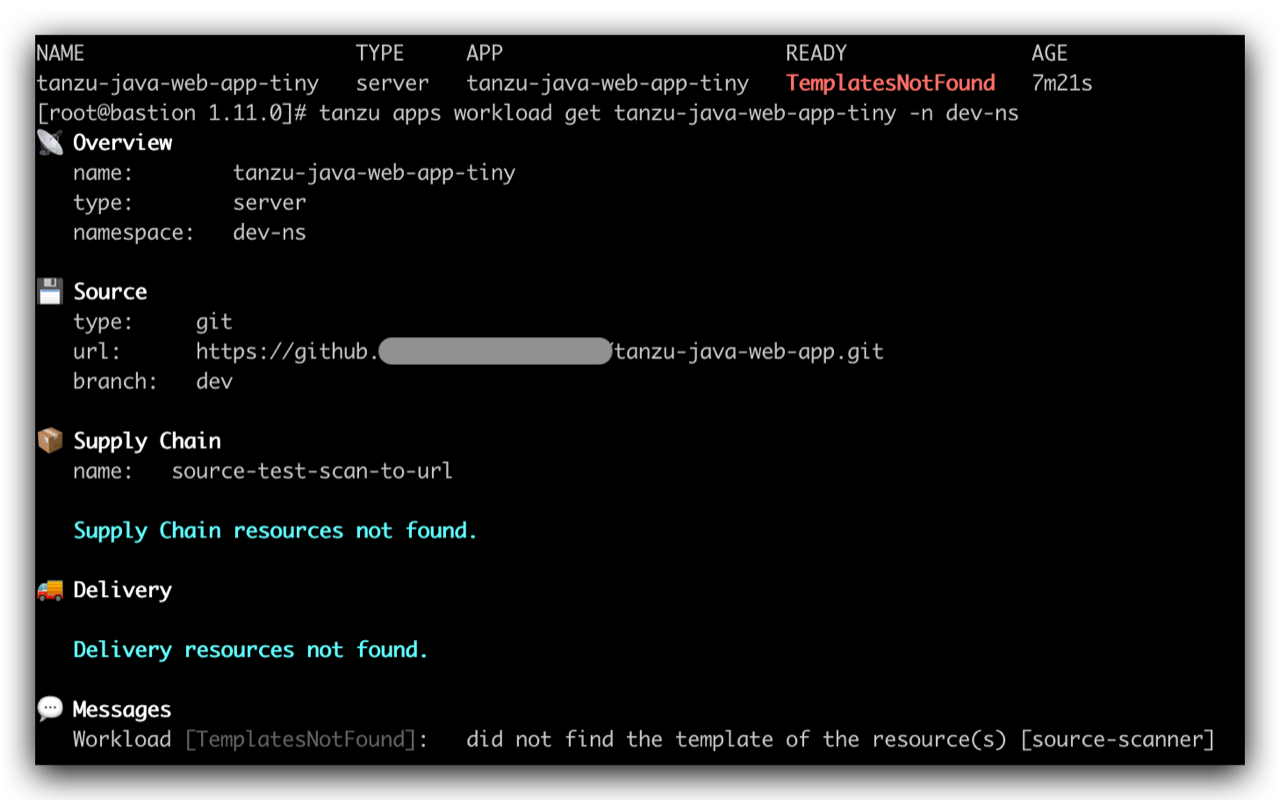

Post upgrade TAP v1.12, the workload tanzu-java-web-app-tiny failed with below error message " Workload [TemplatesNotFound]: did not find the template of the resources) [source-scanner] ", screen-shot as below:
Source scanning was removed from the default behavior in TAP 1.6. At the time it was scheduled for removal in TAP 1.9 with the deprecation of Scanning V1. Scanning v1 was deprecated in TAP 1.10, more details can refer to doc: https://techdocs.broadcom.com/us/en/vmware-tanzu/standalone-components/tanzu-application-platform/1-8/tap/scst-scan-overview.html . The template ClusterSourceTemplate "source-scanner-template" was removed in TAP 1.12.
The template ClusterSourceTemplate "source-scanner-template" is removed from the product, so better to not use it in the long run. There was reason for removing SCA scanning, as often it does not provide the true security posture since the scanners require the code to be built to provide accurate information and in this case the scanning was happening before code is built, also scanning happening via image scanning would capture the CVEs that SCA would have.
If customer still need to use this template, they can create it manually with below yaml file.
