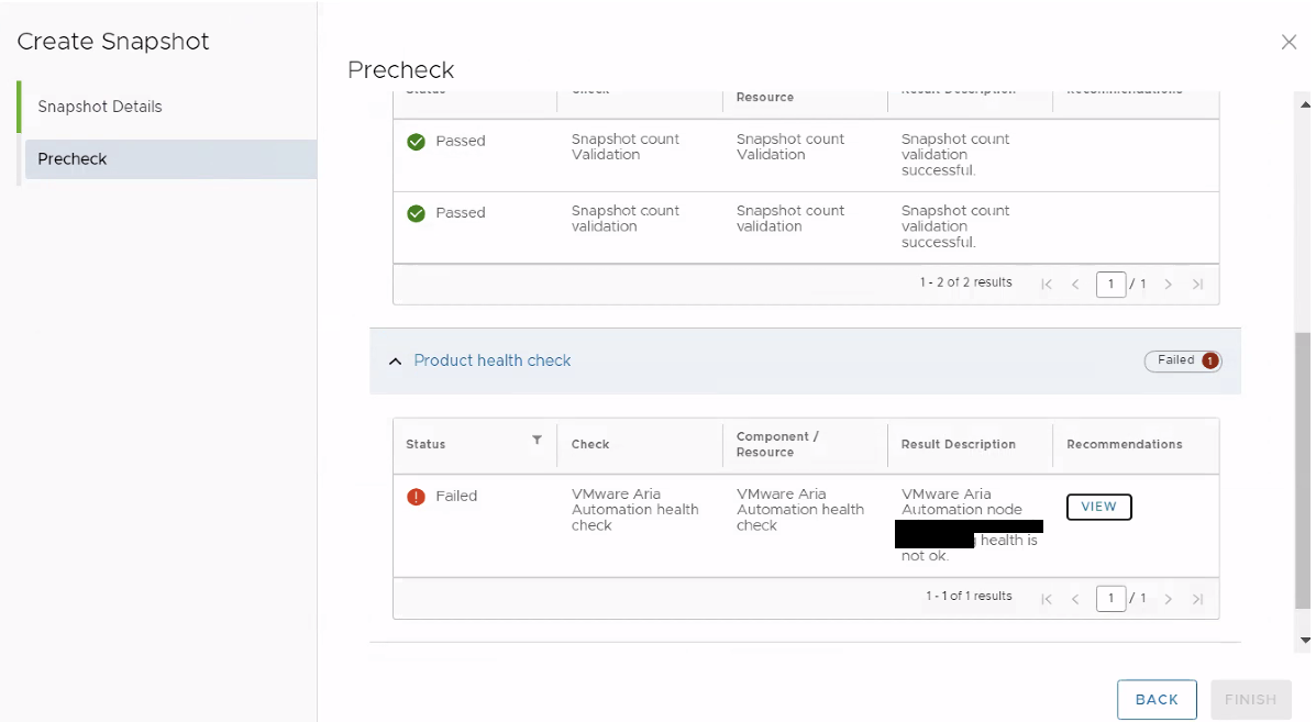

  • In VMware Aria Automation, snapshot creation from Aria Suite Lifecycle fails during the "Product health check." The health check shows that one of the Aria Automation nodes, is not in a healthy state, preventing successful snapshot creation.
  • While the pre-check for datastore validation passes, the overall snapshot pre-check health check fails due to reported issues with Aria Automation health on a specific node.
  • Below messages were seen in the Precheck Report:
    • VMware Aria Automation node xxxxxx.xxxxx.xxx health is not ok.
    • Please make sure that VMware Aria Automation is in healthy state.

  • The snapshot creation failure is due to a Product health check error on a specific Aria Automation node, specifically related to datastore validation and disk space issues. Limited free space in the /home partition on the affected node is causing the Product health check to fail.
  • Verify Health of Aria Automation Components:
    • Confirm whether Inventory Sync for Aria Automation is successful in Aria Suite Lifecycle. Typically, Inventory Sync will complete without any issues.
    • SSH into Aria Automation node and run the following commands to verify that all nodes and pods are healthy:
      • kubectl get nodes
      • kubectl get pods -n prelude
      • vracli service status
  • Remove Old Snapshots and Unneeded Files:
    • Attempt to delete any old snapshots via Aria Suite Lifecycle and clear unnecessary log bundles from /home partition on the reported node.
  • Verify Disk Usage:
    • Use vracli disk-mgr command on each node to check free space. Logs from Aria Suite Lifecycle point to limited space on the /home partition (18% free space) in the below e.g.: (Typically, free space on all partitions in Aria Automation nodes should be more than 25%)
    • Once insufficient disk space is confirmed, identify and remove unnecessary files (e.g., older log bundles) to free up space from the /home directory.
  • Run Disk Manager and Snapshot Validation:
    • Run vracli disk-mgr command on all three nodes and verify output to ensure datastores meet requirements.
    • Once Aria Automation health is addressed and sufficient disk space is available, rerun the snapshot pre-check validation within Aria Suite Lifecycle.
    • This time the Snapshot Validation should be successful.
