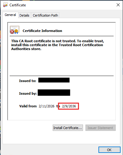

You should check to see if the EEM certificates might have expired.  To do this, locate your "rootcert.cer" file in the C:\Program Files\CA\SC\iTechnology folder.  Double click on this file and you will see a window with the certificate details:
If the expiration date you see there is alerady passed, for example:
then the certificate is expired and must be regenerated.  To regenerate the certificates, followed the instructions here
