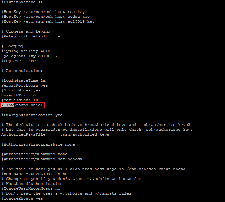

  • In vCenter, the sshd_config file contained the following parameter:
  • The AllowGroups parameter in the sshd_config file is a configuration directive that restricts SSH access to users who are members of the wheel group. This means that only users who belong to the wheel group are allowed to authenticate and connect to the system via SSH.
  • wheel is typically a special administrative group in many UNIX-like systems, including Linux and macOS, that is often used to grant users the ability to perform administrative tasks (e.g., sudo access). The wheel group is commonly used to restrict certain administrative commands or provide privileged access.
  • Determined that SSH access was blocked due to `AllowGroups wheel` in `/etc/ssh/sshd_config` following the error logged in messages file.
  • Created a backup of the original `sshd_config` file:
    • cp sshd_config sshd_config.bak
  • Took a non-memory, non-quiesced snapshot of the vCenter system.
  • Opened `/etc/ssh/sshd_config` with `vi` editor and commented out the `AllowGroups wheel` line.
  • Saved the modified `sshd_config` file.
    • Press ESC
    • Type :wq! and hit Enter
  • Restarted the SSH service to apply the changes.
  • Verified that SSH access was restored and successfully logged in and revoked if the parameter `AllowGroups` wheel is removed from the comment.
  • Monitored the system to ensure normal operation after the update.
If in any case the above solution does not work, then add the root user in the Allow Groups
For Example:
 AllowGroups wheel root
