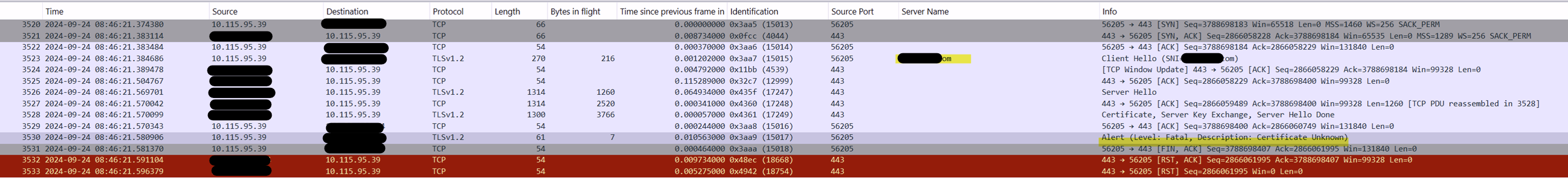

Getting access to the Symdiag output when the issue was reproduced allowed us to track all SSL sessions and confirm whether any failed. In our case, we identified a session to a cert signing domain (clue was in the name!) where the SSL handshake had failed on the client side. Suspecting some certificate pinning issues, the domain was added to the SSL interception bypass list.
Doing so fixed the issue.
