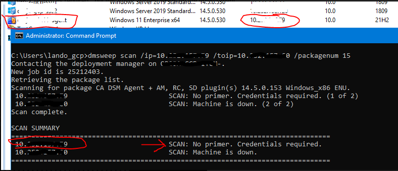

But when running dmsweep scan command, sometimes an existent machine is listed as non managed machine:
Client Automation 14.x
This behavior happens when scanned machines have an Agent, but no DM Primer installed.
A possible workaround is to manually install DM Primer on existent Agent machines, as explained here:
Manual Installation of the Infrastructure Deployment Primer Software
dmsweep is the command line interface of DM Deployment Manager, which is used by Deployment Wizard, so it directly depends on DM Primer to get the required information, for installation and also for scan.
