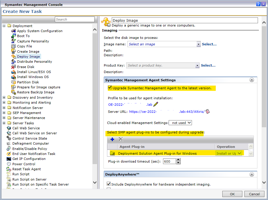

You are trying to re-image pre-existing client computers. While running a task to "join a computer to the domain", please see Creating System Configuration Settings, the task is erroring with the following message:
ErrorMessage: ConfigException occured 'ConfigDll could not find the config toolbox', return code 0, system error 'The system cannot find the file specified (0x00000002)', location 'ConfigDll.cpp:154'
If you run the task but don’t specify an OU to move it to, it works fine and is joined and placed under the root "Computers" OU.
If you specify an OU, you get this error above.
You’ve checked that the OU you’ve specified in the task exists, and you’ve re-confirmed the account in question has rights to move computers into the task’s specified OU when done directly via AD Users and Computers (as well, it does work if you join the domain manually with those same credentials).
This "join a computer to the domain" task started to give the above message after upgrading to Deployment Solution 8.7
ITMS 8,7
SMA (Symantec Management Agent) and DS (Deployment Solution) plugin upgrade were not enabled during Image deployment.

  • Look at your "Deploy Image" task. There are options that you can enable for making sure the most current agent version is in place (this "Symantec Management Agent Settings" section didn't exists on pre-8.7 versions):
     "Upgrade Symantec Management Agent to the latest version"
    As well, make sure the Deployment Solution Agent Plug-in for Windows has the option to "Install or Upgrade"
The option in the task doesn't require standalone agent / plug-in policies to be enabled.
