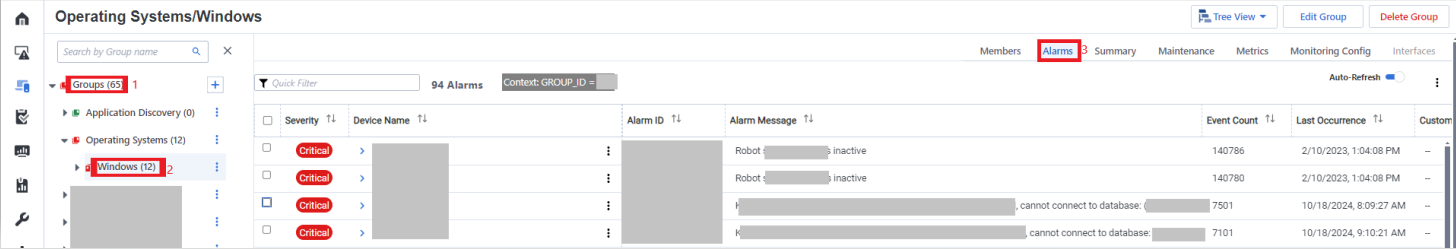

Acknowledge of multiple Alarms does not work Via OC then Group then select a group then Alarms tab, however, Acknowledging the alarms from Alarm Management then Alarm Console is working fine.
