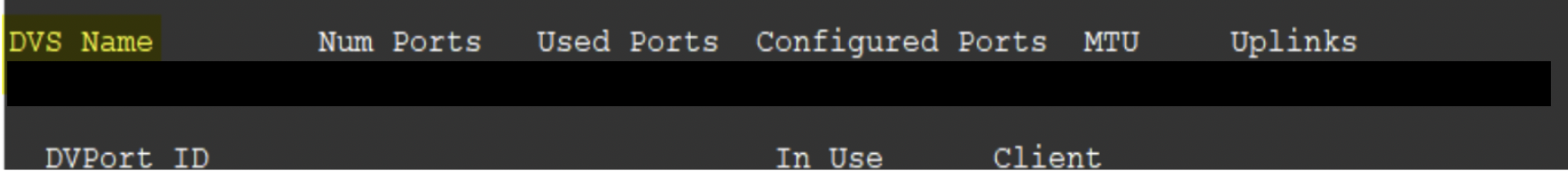

Obtain the name of the vDS which needs to be modified via the esxcfg-vswitch -l command.
For each vDS in use by NSX, issue a command similar to the following to disable the active NSX kernel module(s):
Command syntax : net-dvs -u <propertyName> -p hostKeyValueDataList <SwitchName>
Example commands to remove the properties com.vmware.net.portset.fc.enabled and com.vmware.net.portset.fc.mcast.enabled :
  • net-dvs -u com.vmware.net.portset.fc.enabled -p hostPropList <SwitchName>
  • net-dvs -u com.vmware.net.portset.fc.mcast.enabled -p hostPropList <SwitchName>

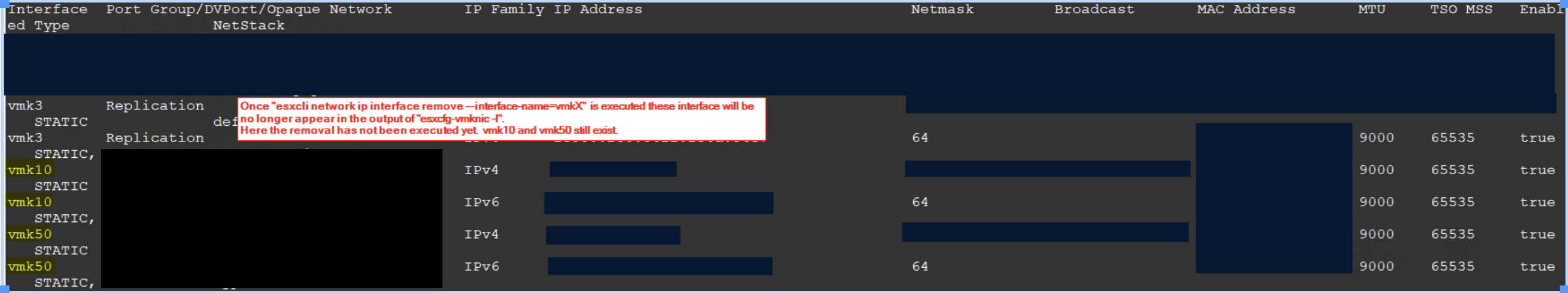

There is a possibility that when removing properties  com.vmware.nsx.vdl2.enabled and com.vmware.nsx.vdr.dvptracking that it will fail.
The failure will state the resource is busy.  The cause of this is the presence the kernel interface created when NSX is installed on the host (vmk10, vmk11, vmk50).
These interface will need to be remove via the following commands executed ESXi host command line.
Removal of a kernel interface:
esxcli network ip interface remove --interface-name=vmk10
Verification can be done with the following command:
esxcfg-vmknic -l
