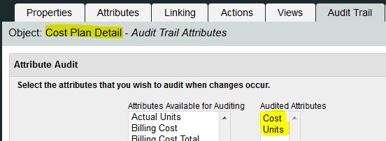

We have configured the Benefit Plan Detail and Cost Plan Detail Object to have some attributes enabled for Audit Trail. When we go to the Audit tab on the Cost Plan, we get an alert message indicating we have not configured any attributes for audit trail. Why do we see this message?

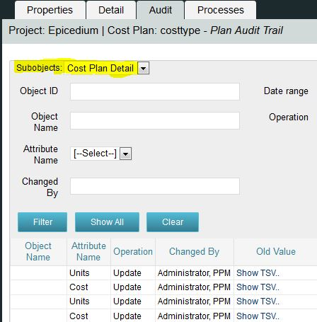

Alert:ODF-0800: No attributes were selected for auditing. Contact your administrator.
Steps to Reproduce:
Follow the steps below to enable auditing on at least 1 attribute on the parent object. Repeat the steps for any other parent object for which you need to see sub-object audit trail records.
