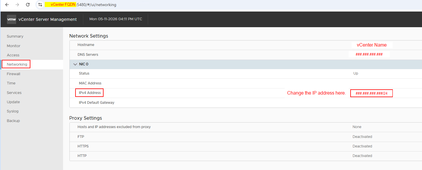

  • Changing the vCenter IP.Open the vCenter VAMI    https://<vCenter FQDN>:5489
    This is where the IP for vCenter is set or changed.

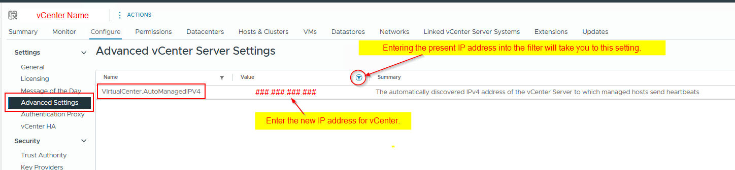

  • Next in the vCenter advanced setting enter the new IP in VirtualCenter.AutoManagedIPV4.
    The IP of vCenter has now been changed.
Also ensure to verify runtime settings on vCenter: Verify that the vCenter Server managed address field is reflecting the NEW IP address using the following KB:
