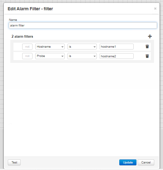

Is it possible to create an alarm filter with the operator OR when creating an Alarm Datasource in the DX UIM Dashboard Designer?
I don't see any way to add an OR logic filter

The Alarm Datasource/ alarm filters in the DX UIM Operator console Dashboard Designer does not have the ability to add an "OR" operator filter.

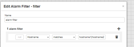

However, the filters support the "matches" operator. The matches operator fully supports Regular Expression (Regex).
•  For example, if you want the filter to show only alarms from either hostname1 OR hostname2 you can use the following filter:
1. hostname marches hostname1|hostname2
•  More complex Regex is also supported. For example: you want the filer to display alarms from hostnames that contain the work "name1" OR "name2" AND the probe to be either "cdm" OR "logmon"
You need to filters:
1. hostname matches .*name1.*|.*name2.*
2. probe matches cdm|logmon
