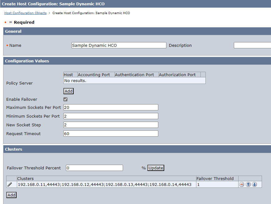

This article is to provide more detail in how to configure DynamicHCO and what is possible and not.
In order to use DynamicHCO, it must be enabled in the SmHost.conf file.
enabledynamichco="YES"
And HostConfigObject must be configured to use the Cluster setting.
Multiple Clusters can be configured as well and can set threshold for failover between clusters.
