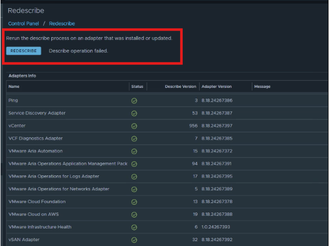

On Aria Operations UI, Redescribe shows the following error:
When try to perform a "Redescribe" operations, the following error is recorded in analytics-########.log:
Note: The sample Error below depicted the failure due to the Dell EMC Management pack.
ERROR [DistTaskDistributedTaskDescribe] com.vmware.vcops.controller.data.utils.AdapterDescribeManager.describeAdapters - Describe failed java.lang.RuntimeException: Describe would remove resources, so we are failing to describe. Problematic resource kind is EMC:Disk. Please mark this kind as deleted to remove with the child resource or repair the adapter and try again!
