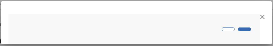

After upgrade to DLP 16.0.2 "RU2" Smart response rules appear to be broken, and otherwise comes up blank.
When clicking any pull downs in an incident with a smart response rule nothing happens.
