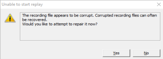

When we try to start a .urc file (Remote Control Recording file), following error appears :
The recording file appears to be corrupt. Corrupted recording files can often be recovered.
Would you like to attempt to repair it now?
And the repair operation does not work.

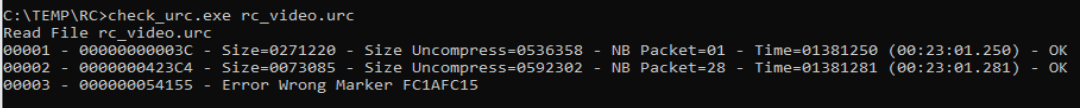

- rc_video.urc is corrupted :

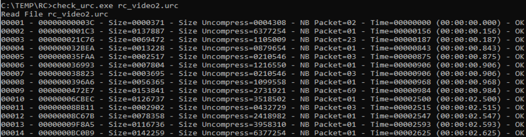

- rc_video2.urc is OK :

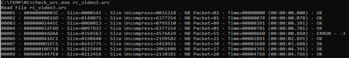

- rc_video3.urc has a corrupted chunk (chunk starts at offset 0x4ADAA) :
