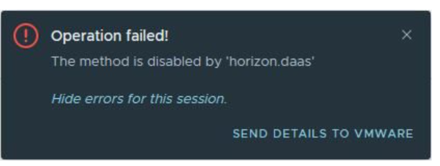

We cannot delete VM folder from the vCenter and get an error "The method is disabled by 'horizon, daas'. "

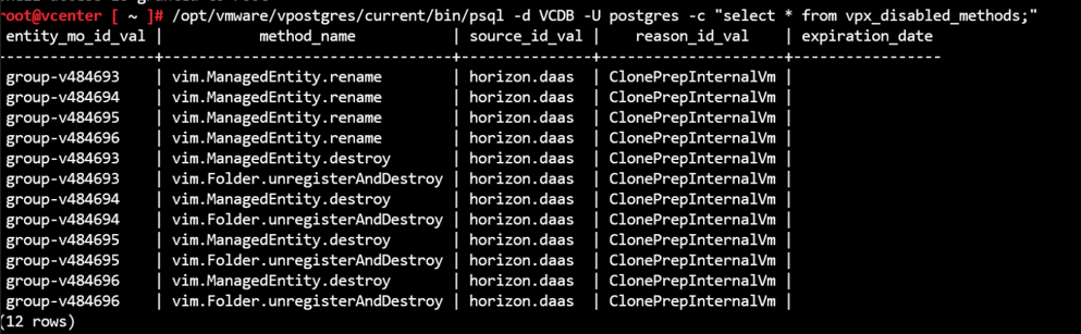

VM folders created by VMware Horizon cannot be deleted directly through the vCenter Server. The error message indicates that these folders are protected by default settings within VMware Horizon. To confirm this, you can query the vCenter database for disabled methods associated with the VM folders. Use the following command:
/opt/vmware/vpostgres/current/bin/psql -d VCDB -U postgres -c "select * from vpx_disabled_methods;"
The output will be as follows :
The output will list the details of the managed object (MOB) ID of the object and the operations that are currently disabled.

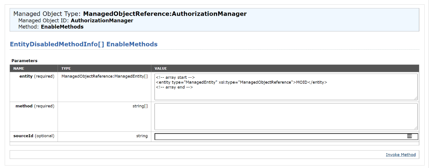

  2. Connect to the MOB Page
    https://<vCenterFQDNorIP>/mob/?moid=AuthorizationManager&method=enableMethods
  3. Log in with your administrator credentials (e.g., [email protected] or an SSO admin user).
     5. Below page will appear :
   6. In the first parameter entity value box, replace MOBID with the actual MOB ID you identified earlier.
   7. In the second parameter method value box, enter the method name corresponding to the task you want to perform, as noted in the output from the database query.
The syntax for the same is  <method>taskfromthelistabove</method>
8. Click on Invoke Method.
9. After invoking the method, refresh the vCenter Server web client. You should now be able to delete the VM folder.

3. To find all objects that are causing the issue, execute the following command:
