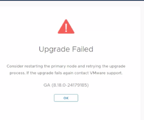

  • During an upgrade of VMware Aria Operations for Logs from version 8.16.1 to 8.18.0, the upgrade process failed due to insufficient space in the /boot partition.
  • This error was detected in the upgrade log, which showed that at least 41 MB of additional space was required. The upgrade process halted, and corrective actions were needed to resolve the issue.

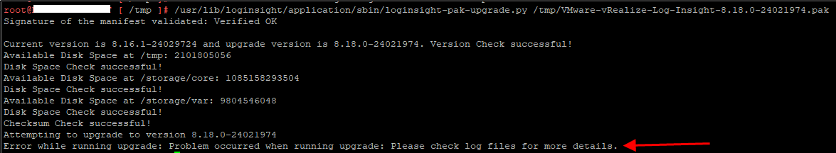

  • Below errors can be seen in /var/log/vmware/loginsight/upgrade.log file.
    • 2024-10-03 04:23:56,286 update-photon-based-boot.sh ERROR There is no enough space in /boot. Required space is 40900 KB.
    • 2024-10-03 04:23:56,286 update-photon-based-boot.sh ERROR Exiting the upgrade process.
    • 2024-10-03 04:23:57,415 initialize-partitions-update.sh INFO Successfully restored boot partition /boot
    • 2024-10-03 04:23:57,418 initialize-partitions-update.sh INFO Cleaning up upgrade files
    • 2024-10-03 04:23:57,781 initialize-partitions-update.sh ERROR Failed
    • 2024-10-03 04:23:57,781 initialize-partitions-update.sh ERROR Exiting the upgrade process.
    • 2024-10-03 04:23:57,784 upgrade-driver INFO Exception occurred!!!
    • 2024-10-03 04:23:57,784 upgrade-driver INFO Cleanining up upgrade version file
    • 2024-10-03 04:23:57,785 upgrade-driver INFO Failed to remove /storage/core/upgrade-version files
    • 2024-10-03 04:23:57,785 upgrade-driver INFO Restarting Log Insight
    • 2024-10-03 04:24:17,592 upgrade-driver INFO Finished running upgrade-driver script.
    • 2024-10-03 04:24:17,609 loginsight-pak-upgrade INFO Exception encountered during key generation, continuing: Strings must be encoded before hashing
    • ERROR: Failed to run partitions update script
    • 2024-10-03 04:24:17,610 loginsight-pak-upgrade INFO Problem occurred when running upgrade: Please check log files for more details.
    • 2024-10-03 04:24:17,615 loginsight-pak-upgrade ERROR Error while running upgrade
    • Traceback (most recent call last):
    • File "/usr/lib/loginsight/application/sbin/loginsight-pak-upgrade.py", line 523, in main raise UpgradeError(err)
    • UpgradeError: 'Problem occurred when running upgrade: Please check log files for more details.'
  • Upgrade failure screenshot - UI
  • Upgrade failure screenshot - CLI

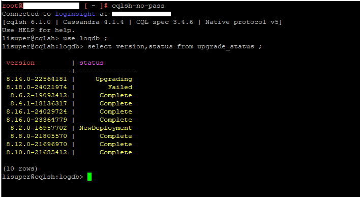

  • The cause of the upgrade failure is due to kernel files being retained in the /boot directory from previous upgrade attempts that were left in a Failed, Pending, Upgrading, or In-progress state.
  • The upgrade process requires a certain amount of free space in the /boot partition to proceed. During the upgrade, the system logs reported that there was insufficient space (less than the required 41 MB) to complete the process.
  • Multiple older kernel files were present in the /boot partition, occupying the space needed for the upgrade.
  • Please refer to the steps in the KB below to verify the state of previous upgrade attempts. Ensure that the previous upgrades are either in a "Completed" or "Failed" state. Any state other than "Failed" or "Completed" may result in kernel files being retained in the /boot directory.

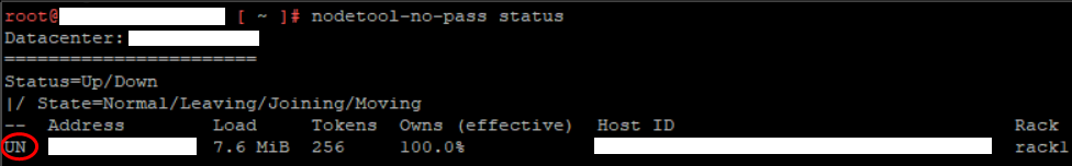

  • Verify Node Status:
    • Run nodetool-no-pass status command to ensure that the node is in the UN (Up Normal) state. If the node(s) is in DN state then it is required to resolve the underlying issues first and then proceed with the upgrade.
  • Identify the Issue in Logs:
    • Check the upgrade logs using less /var/log/vmware/loginsight/upgrade.log to see if there are any errors related to space. For e.g.

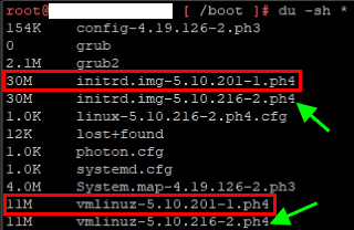

  • Locate Old Kernel Files:
    • Use cd /boot/ and then du -sh * command within the /boot directory to list large files:
      • initrd.img-5.10.201-1.ph4 (30 MB)
      • vmlinuz-5.10.201-1.ph4 (11 MB)
    • The files listed above and marked in Red in the screenshot below are the older kernel files and the kernel files that are highlighted in Green are the current kernel files that are being used and should NOT be moved anywhere.
  • Free Up Space:
    • Since the current kernel version was 5.10.216-2.ph4, the older kernel files were moved to /storage/core/ location using the following commands:
      • mv initrd.img-5.10.201-1.ph4 /storage/core/
      • mv vmlinuz-5.10.201-1.ph4 /storage/core/

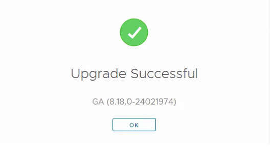

  • Re-initiate the Upgrade:
    • Re-initiate the upgarde through the UI, and this time the upgrade should complete successfully.
