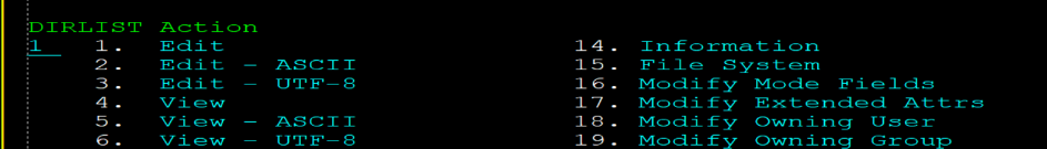

2. Edit the starthc.sh in EBCDIC format (ISPF 3.17 "Udlist Print or display (to process) z/OS UNIX directory list ")
3. Input a forward slash "/" on the starthc.sh file and select option 1
