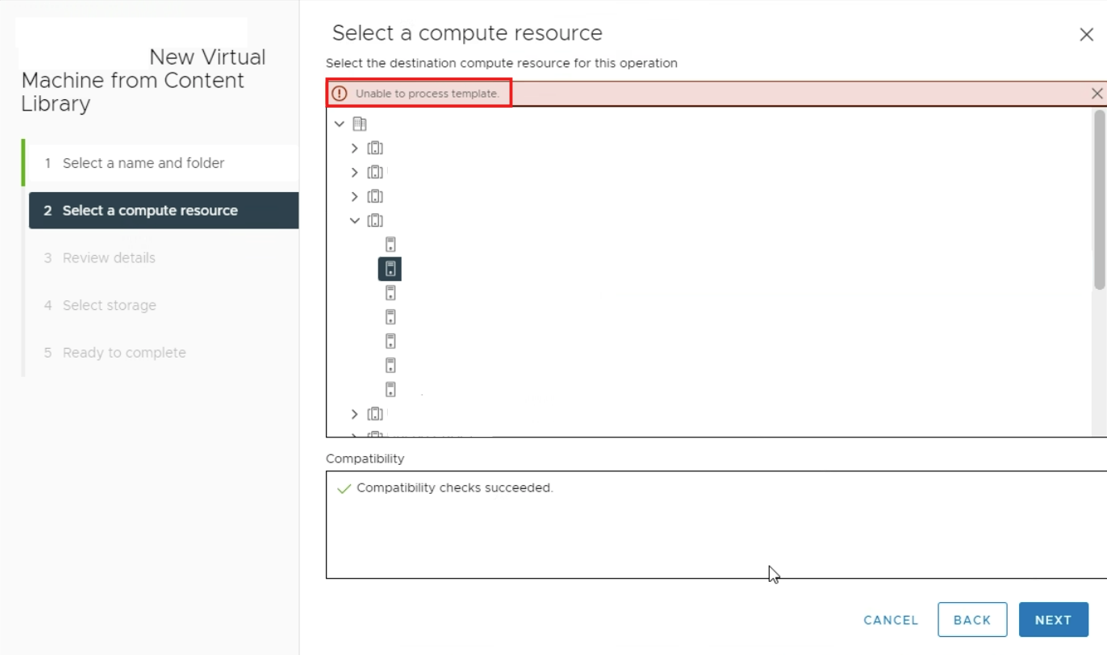

  • Deploying VM/OVF/OVA or Template Local (Publisher) Content Library throws Error: Unable to process template while selecting Compute resource
  • Deployment task is seen stuck at 0% without progress
  • Creating Test Content Library dose not get created and task for creation is not initiated (Task not created)
  • The issue can also be seen as inability of the publishing and subscribing content-libraries to sync and ability to deploy templates.
  • Content library sync activity stays stuck at 1%

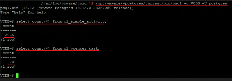

If restarting the service doesn't resolve the issue, check for failed or pending or stale tasks at the Content Library from VCDB using below commands:
  • Use below command to enter VCDB
/opt/vmware/vpostgres/current/bin/psql -d VCDB -U postgres
  • Run below command to identify the failed or pending or stale tasks
select count(*) from cl_simple_activity;
select count(*) from cl_vcenter_task;
Note: cl_simple_activity is the stale entries on the content Library (Pending tasks, failed tasks and total total activities performed) & cl_vcenter_task is the total tasks currently pending to be executed from Content Library.
Example Image below

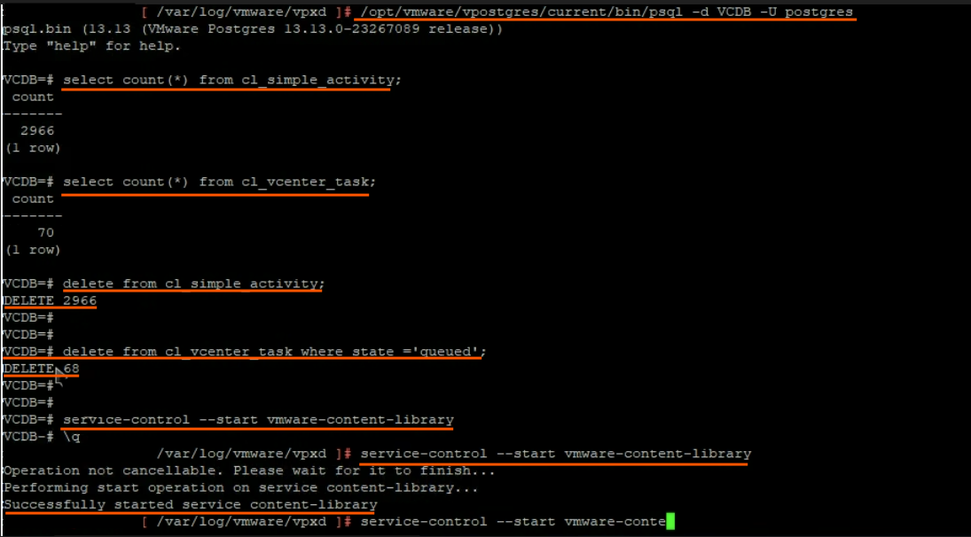

  • Clear the stale entries by running the below command
    • Stop the content library service
service-control --stop vmware-content-library
    • Enter the VCDB
    • Delete the cl_simple_activity & cl_vcenter_task from the above example shared with below command's
delete from cl_simple_activity;
delete from cl_vcenter_task where state ='queued';
    • Start the content library service
service-control --start vmware-content-library
After the database cleanup, the user may need to manually trigger a "Sync" or "Sync Item" to re-populate the state correctly.
