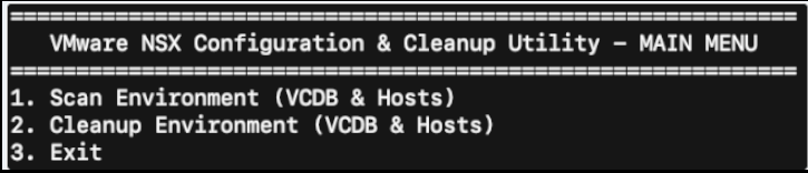

To scan and clean your vCenter Server Appliance (VCSA) and ESXi hosts, please follow these steps:
  1. Transfer the Script copy the cleanup script to the VCSA appliance. Place the file in either the /tmp or /root directory.
  2. Perform a Read-Only Scan run the script and select Option 1. This will scan environment in read-only mode to determine if any cleanup is actually required.
  3. Execute the Cleanup only after reviewing the read-only scan results should you proceed with running the script in cleanup mode against the VC and ESXi hosts.
Vcenter :-
  • Follow these steps to perform the cleanup operation on the vCenter Server Appliance (VCSA)
    1. Stop the VPXD Service Before executing the database cleanup, you must stop the vCenter Server service:
    service-control --stop vmware-vpxd
    2. Backup the VCDB Critical: Always take a backup of the vCenter Database (VCDB) before running the cleanup operation. Run the following command to create the backup in the /var/tmp directory:
    /opt/vmware/vpostgres/current/bin/pg_dump -U postgres -d VCDB -F c -f /var/tmp/vcdb_backup.dump
    Alternative Backup Path: If you prefer or need to back up to the core storage, you can use the following command instead (verify storage space before proceeding): /opt/vmware/vpostgres/current/bin/pg_dump -d VCDB -U postgres -Fp -f /storage/core/VCDBackUp.bak
    3. Execute the Cleanup Script Run the attached Python script (nsx_cleanup.py) to perform the database cleanup.
    • When prompted, select Option 2 (Cleanup Environment).
    • Note: This is the same script used for both vCenter and ESXi host cleanups.
    4. Start the VPXD Service Once the cleanup is complete and the script has successfully exited, restart the vCenter Server service to bring the environment back online:
    service-control --start vmware-vpxd
