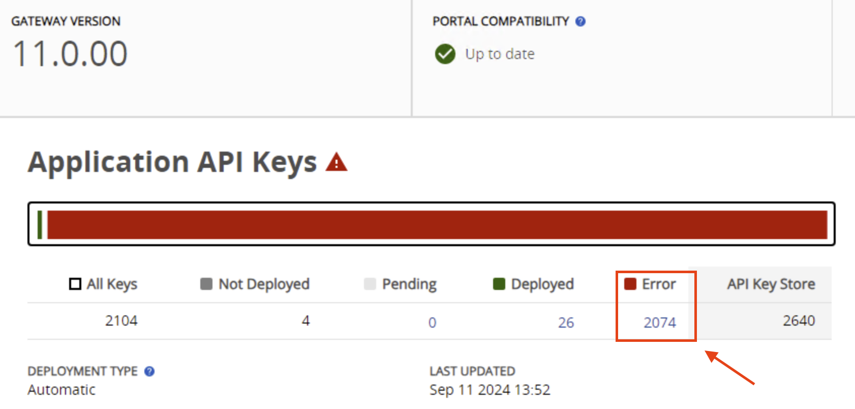

While running a bulk sync, the Application API Keys go in error state
API Portal 5.2+
The issue is with the Applications that were created using the legacy API model (usually migrated through product upgrades) and have a custom field value set as NULL.
1. Before proceeding, run a backup of the Portal Database.
