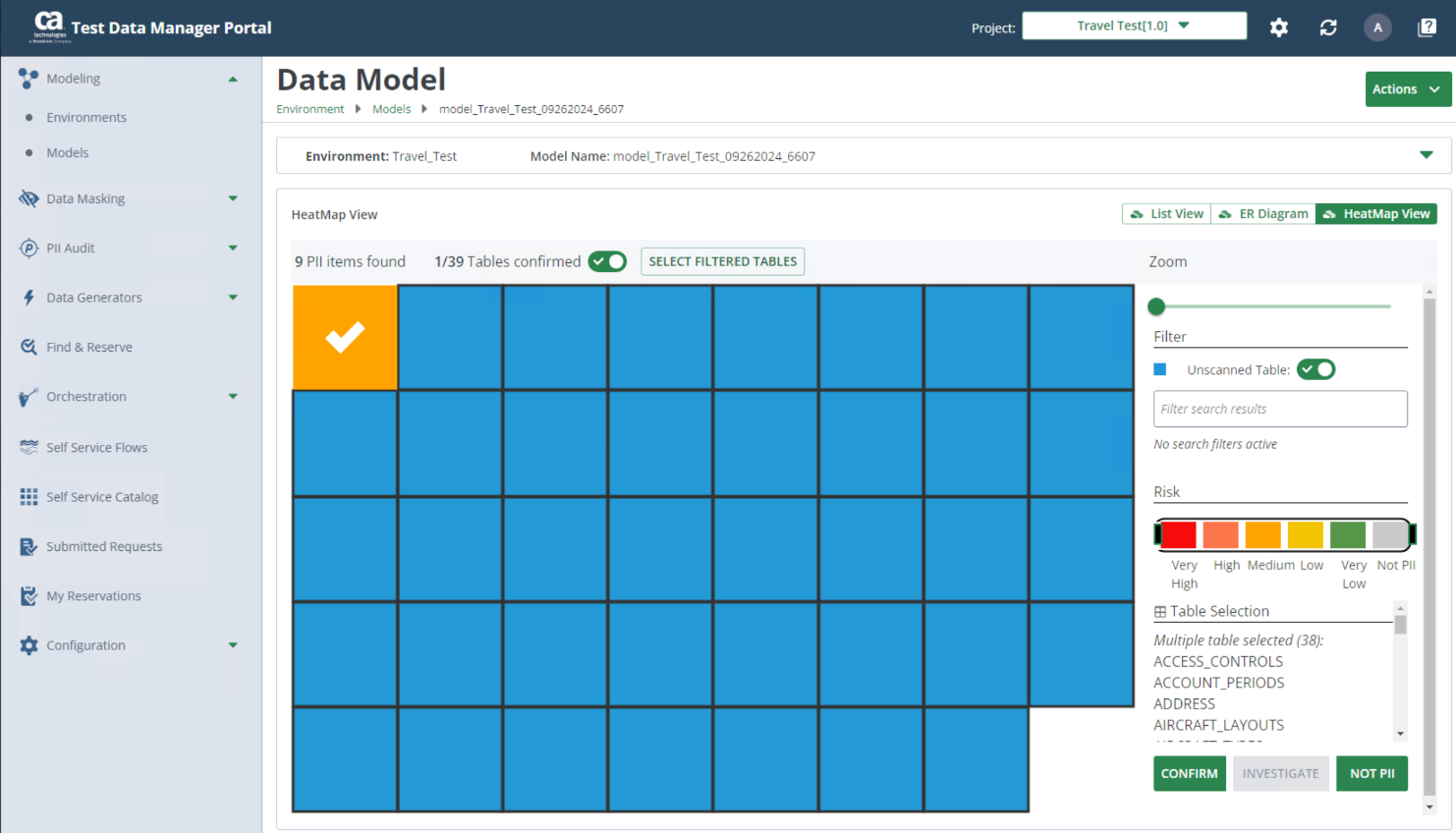

Example of No Filter Applied:
In this example, There's 1 table confirmed, and all other (38 tables) are unconfirmed. There are no filters set in the PII Heatmap View, as you can see on the right-hand side of the page.

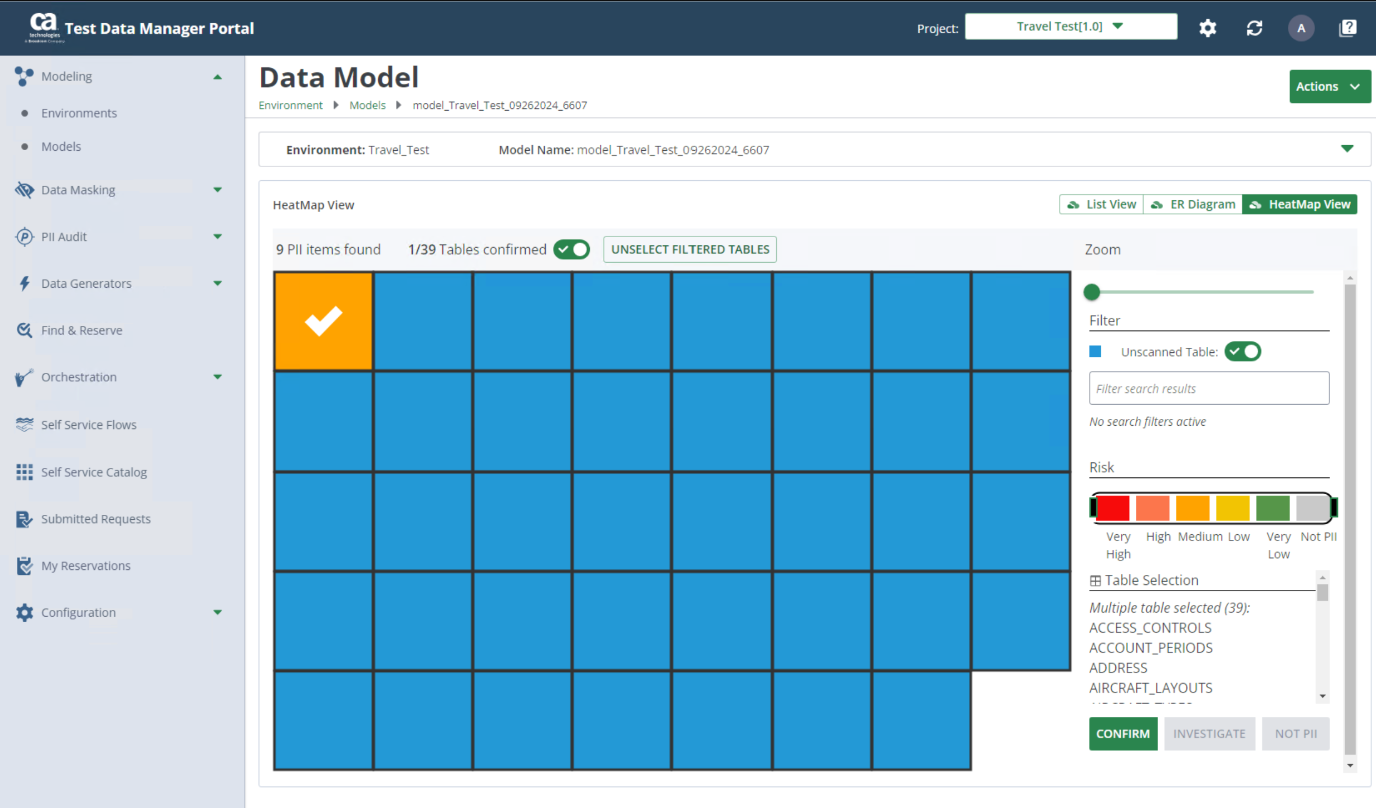

If the "Select Filtered tables" button is clicked, ALL tables are selected (Highlighted/outlined in black), including the confirmed table.
Because the "confirmed" table has been selected, there is only the option to "Confirm" all selected tables. The option to set all selected tables as "Not PII" is disabled, because we have a "confirmed" table selected.

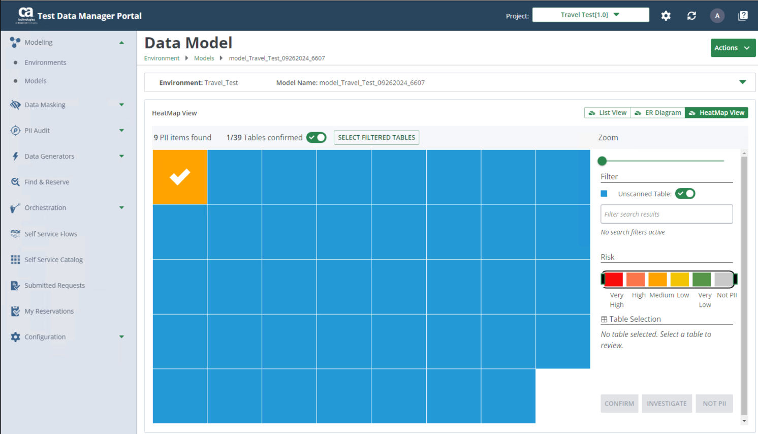

If we simply, unselect the "confirmed" table, by clicking on it, we now have the option to mark the remaining tables as "Not PII" and "Confirm".
